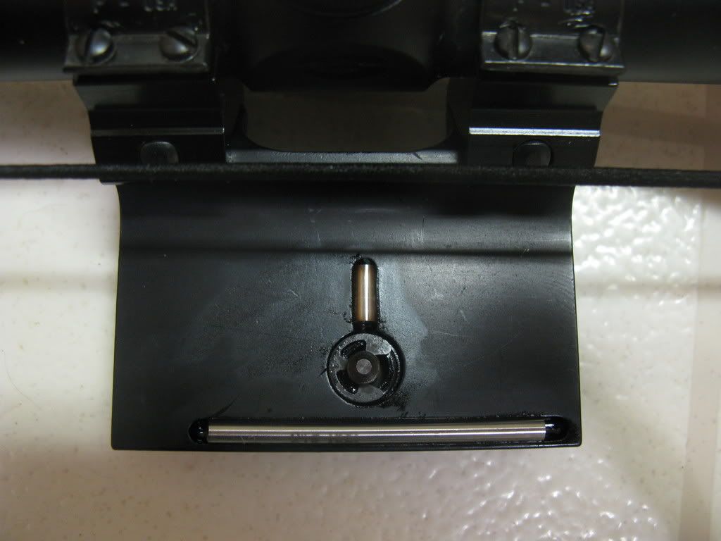

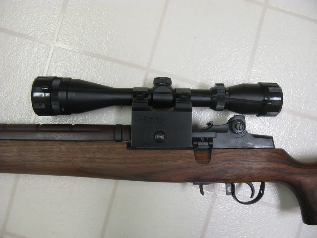

Has anyone looked into the Bassett mount? I bring this up with all credit due to the folks at m14 public forum. Apparently it is well tested, light weight, and can be removed and remounted in seconds without loss of zero. Costs around $100.00. Its hardened aluminum, with stainless steel pins to hold it in position. If you go to his website, they have letters of recommendation from law enforcement and target shooters.
http://i275.photobucket.com/albums/jj308/texfar/IMG_0275.jpg
http://i275.photobucket.com/albums/jj308/texfar/IMG_0269.jpg
http://www.bassettmachine.com/
i looked, and i wonder how those pins are mounted into the aluminum- if it's an epoxy or similar adhesive, or screwed or what?- i still think i'd prefer a steel casting- again, not seeing any wave hapening, so i'd say the arms or smith are still the way to go
They are press fit and locktited into a machined groove.
I agree, the sure bet is the smith or arms. I'm happy with my smith mount. But I look at this Bassett mount with envy of the ability to remove and remount easily with little loss of zero.
