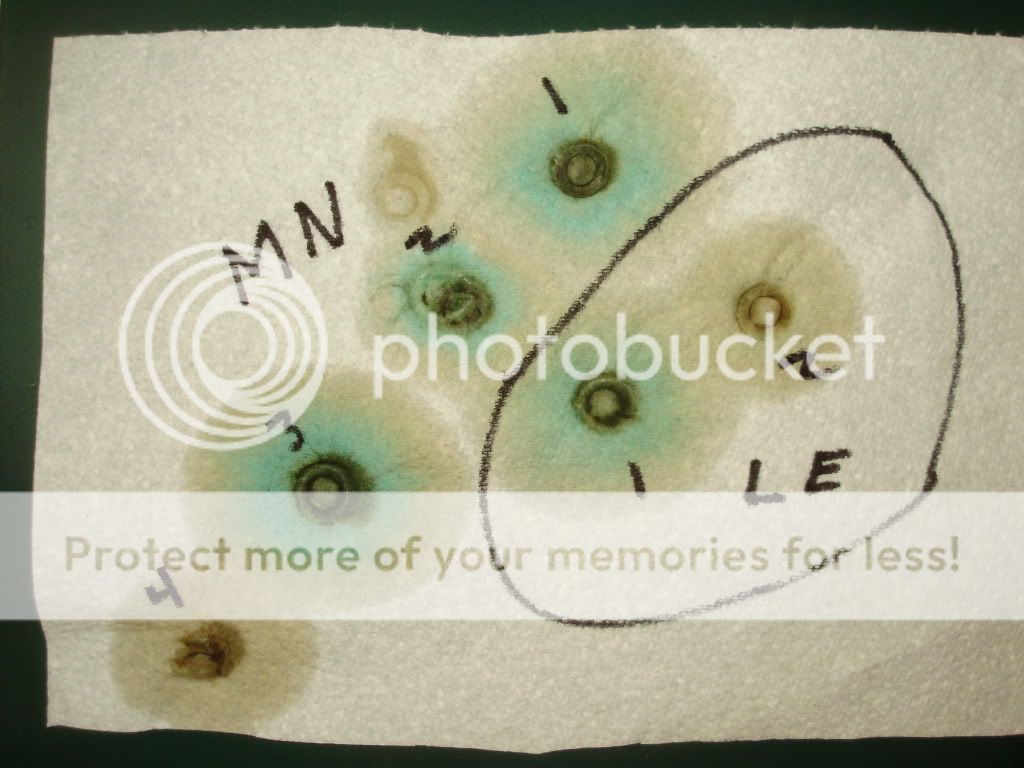

The next step is the metal fouling. Copper solvents do that job. Some are faster than others. Wet the bore and then leave the gun overnight, muzzle down on a pad of paper towel. the stain the next morning will tell you if the barrel is clean. A big blue stain means "not yet". Wipe the barrel again with a wet patch of copper solvent and leave it muzzle down again. When you stop getting the blue stain, it is clean.
Here is a paper towel example. You can see that one gun was clean after two sleep overs. the other took 4.
