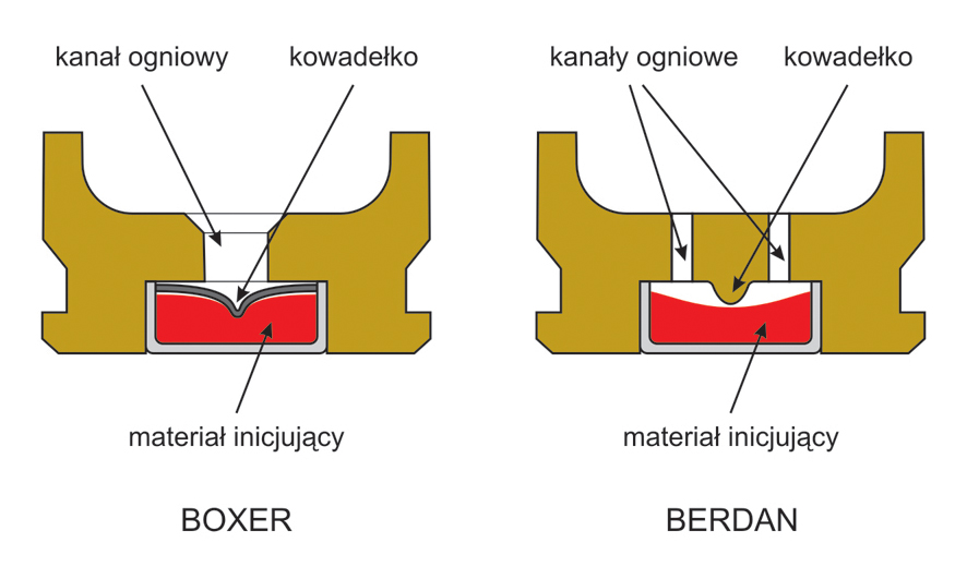

Unless its Berdan primed, I believe u can reload just about any 303 brass out there. The No4 Mk1 is an excellent rifle to start reloading for. You will want to neck-size your brass after you've fired them.

One other comment. While the modern S&B brass is boxer primed and OK to reload, I have both .22 hornet and 8x57JR ammunition from years ago in the old brown and white boxes that are Berdan primed and is not recommended for reloading.
The bullet has nothing to due with the brass. If it has the correct primer{boxer} you are good to go. If however it is berdan primed it isn't worth the time.
