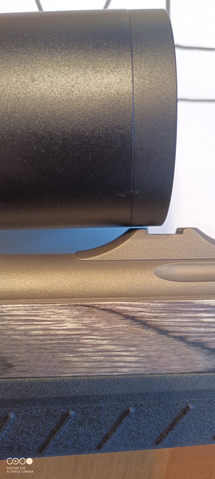

Our recommendation is no less than 1/8th of an inch of clearance between the bottom of the objective and the top of the barrel. Your second choice (0.160) [for scope base height] will give you enough clearance. It is not the heat that will be a problem, it is that your optic could potentially come in contact with the barrel under recoil. If you have time there are plenty of slow motion recoil videos on youtube that are very informative. I hope this is helpful.
