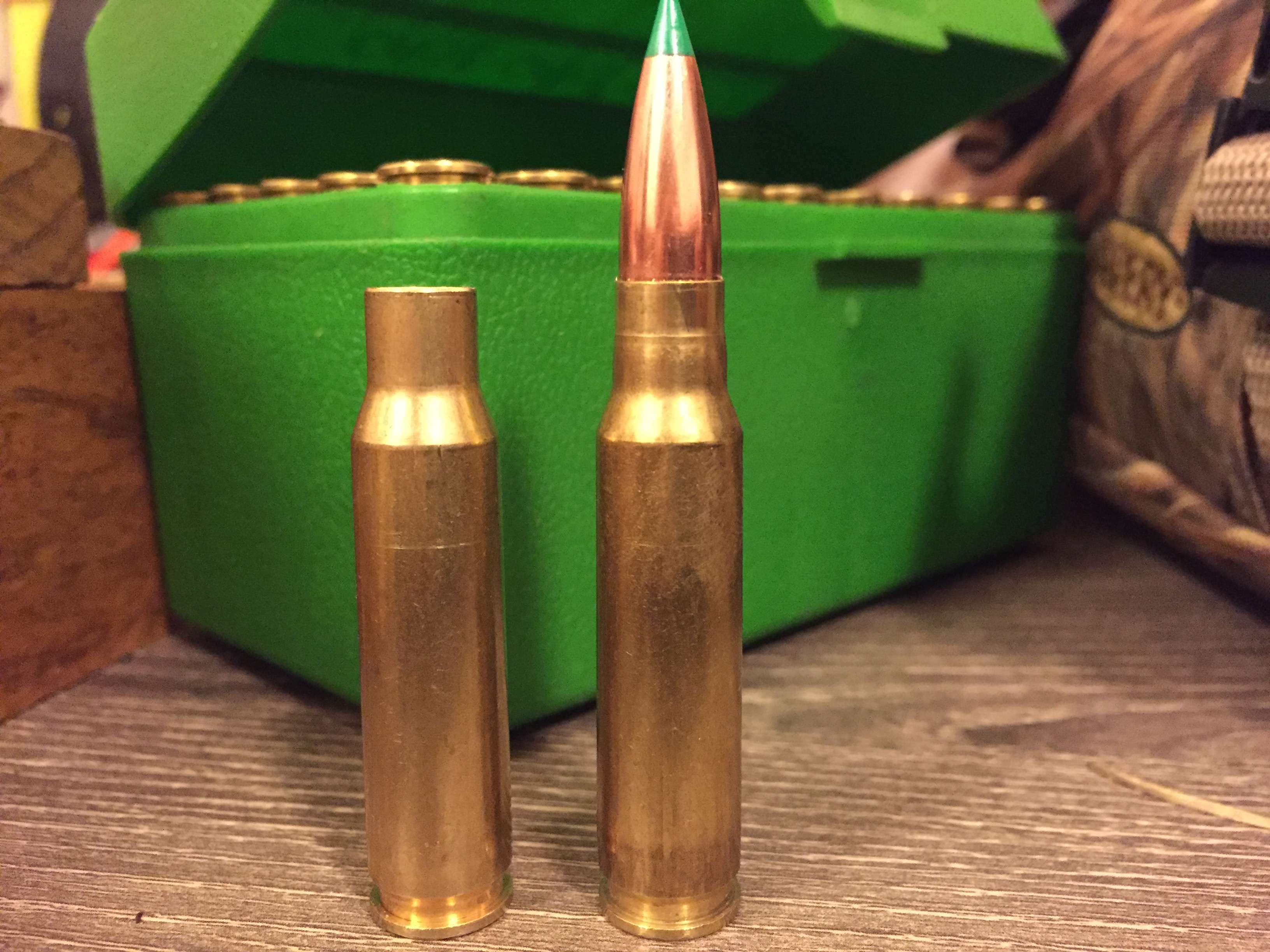

For the time being -
I pulled all the projectiles and resized without the decap pin in place - by the callipers measurements and visual inspection the buldge is GONE !
Reloading them later -
It has been said a couple of times on here, but a body die will solve this problem and virtually any other similar problem you will have, somewhere down the road, with your 308.
A body die is just like a full length resizing die without the centre decapping rod, except the throat is large enough to accept a loaded cartridge, without squeezing the bullet. A body die is often hard to find and almost never talked about, but probably the most useful "extra" a hand loader can have.
