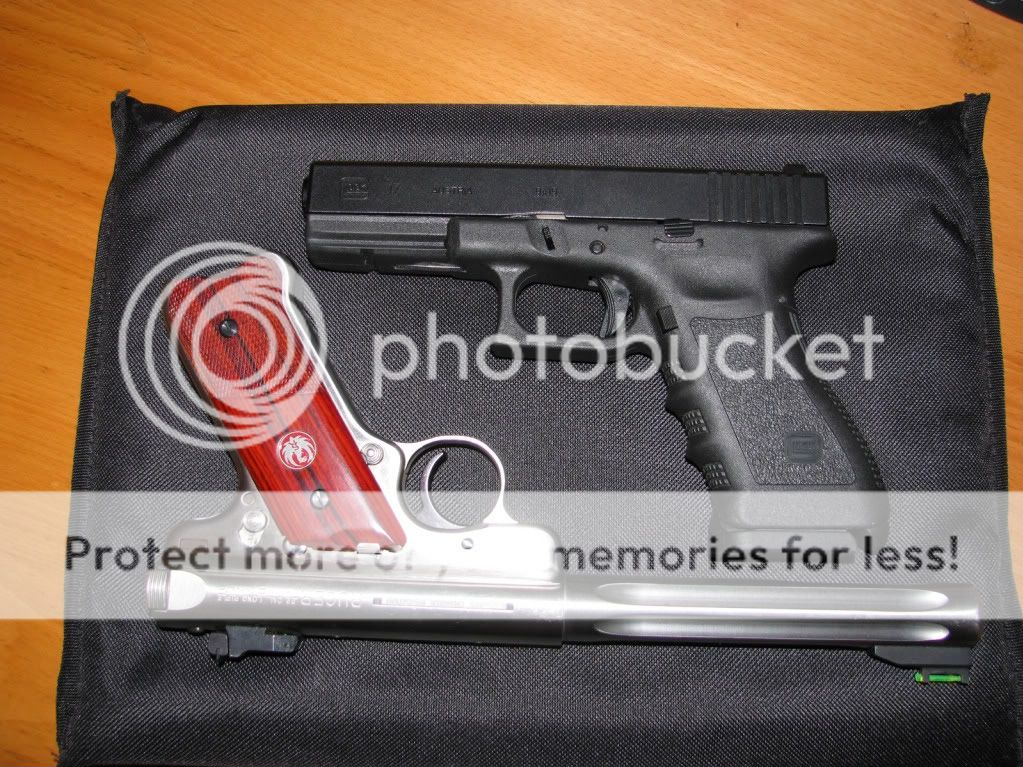

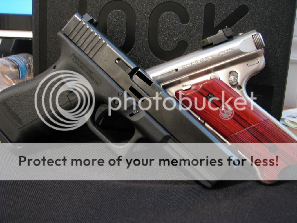

Not that you should give up now, but when I thought about buying the same kit for mine I realized I could get a nice ruger mark3 in whatever model suits you best on the E/E for around 400 bucks. So now I have a nice little .22 gun and my g17. I bought this hunter stainless on the site here for 400 bucks. But again, you may like shooting .22 out of your glock so I'm just suggested an alternative if it get's to that point.

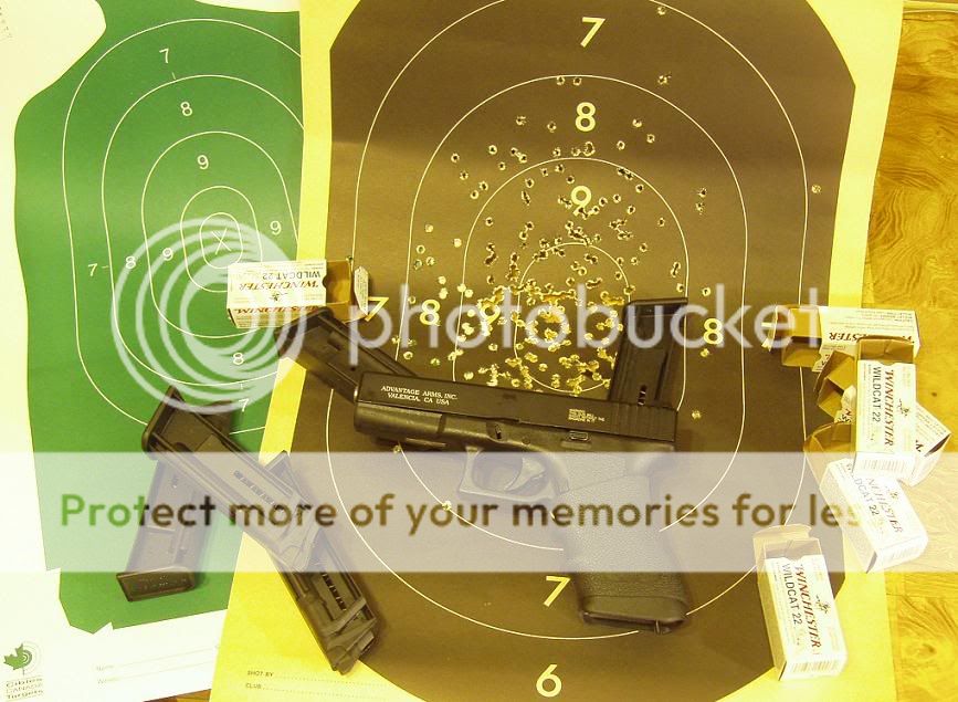

High velocity ammo works best, mina does OK with wildcat (even though it's dirty) and will usually go 300rds before I need to oil it/wipe it down.
