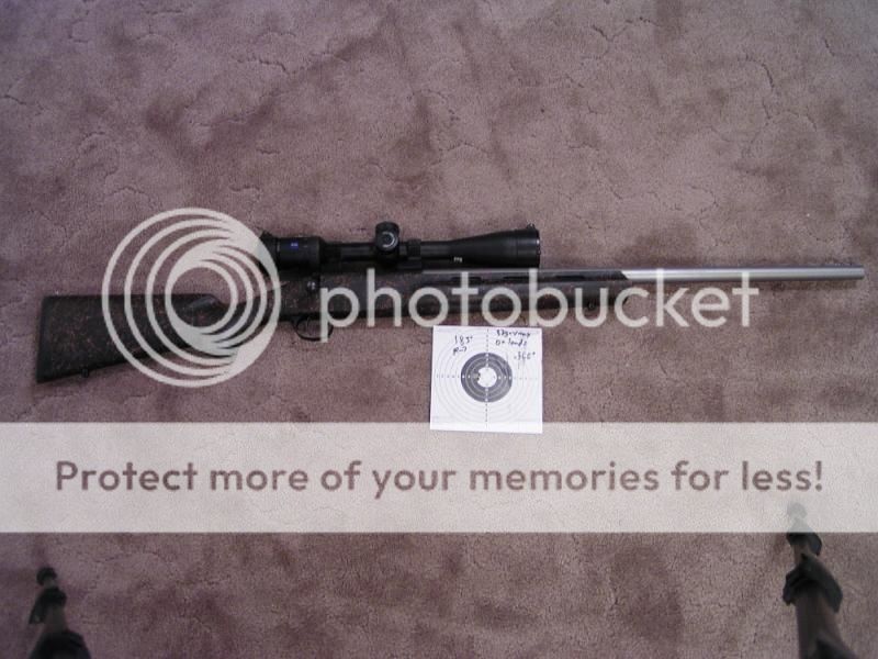

I finally got around to fire forming brass, and developing loads for my new 20 Vartarg. I started with the 32gr v-max seated .010" off of the lands, but the accuracy was only around 3/4" for five shots, not great for a heavy barreled varmint gun, but not bad considering that I was fire forming cases, and shooting at 0 degrees, with snow coming down. At .005" off of the lands, things improved slightly, but still not great. However, with the v-max seated to the lands, and 18gr of R-7, the groups tightened up to under 1/2" for five shots at 100 yards. Below is the rifle, and my last five shot group. I will continue fire forming, until I have a good supply of fire formed brass, and then I will see just how well the rifle will shoot.
