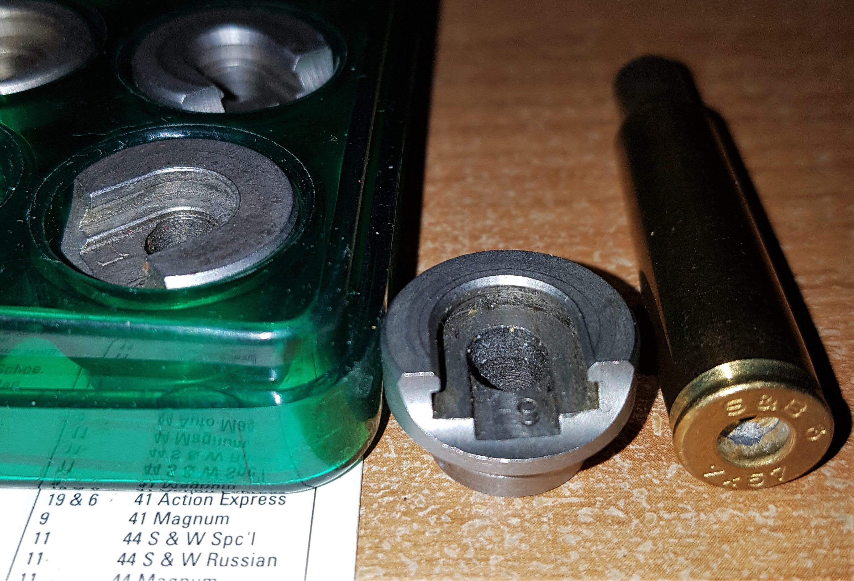

Earlier today was two stainless steel pins getting stuck in the flash hole of a Norma 7x57.
Now I find my S&B 7x57 cases wont take shell holders for .308 win- 8x57 rim cases, like they are supposed to.
Luckily I test fitted it first only to find the Lee #2 shell holder won't fit into the extractor groove.
Lee #9 (.41mag) fits loosely, but is useable.

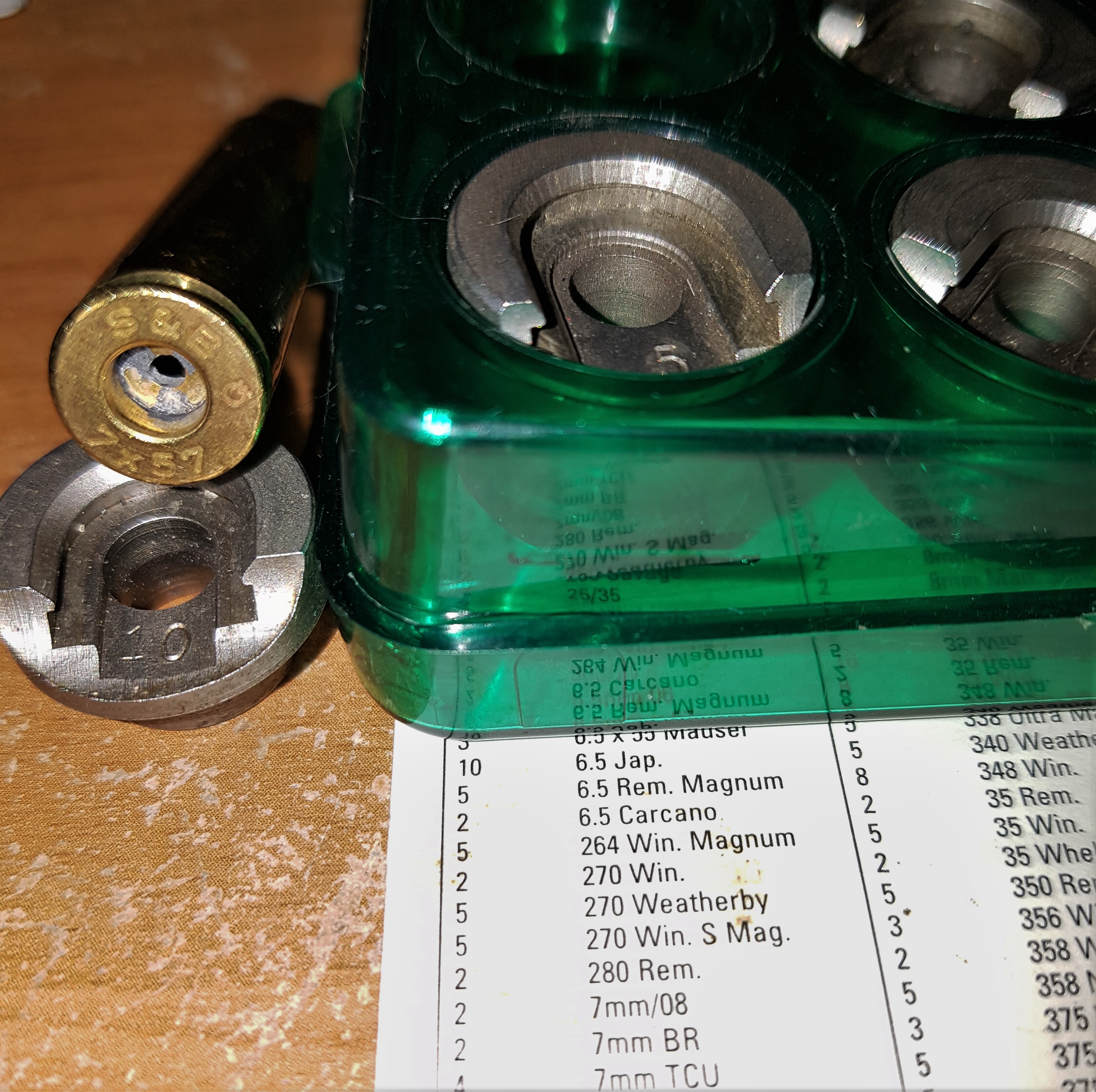

Lee #10 (6.5 Jap) was the best fit of the ones I have.
Just double checked, my S&B 8x57 brass is the same as their 7x57, needs the lee #10 shell holder.
rcbs lists two shellholder options for the 7x57...#3 and #11. Some brass from other countries has different head sizes,(just a bit, but it will foul you up).
Brass built to CIP (European) spec will invariably need a RCBS 11. RCBS makes their shellholders to a pretty tight tolerance. Their lineup has about twice as many #'s as others.
My PRVI 7x57 brass needed an 11.

Came across a few S&B that were over .002" wider than the majority. Too much to enter the close tolerance with the Lee #10 Shell Holder. Guess I'll have a new 6.5x55 shell holder in my future.
