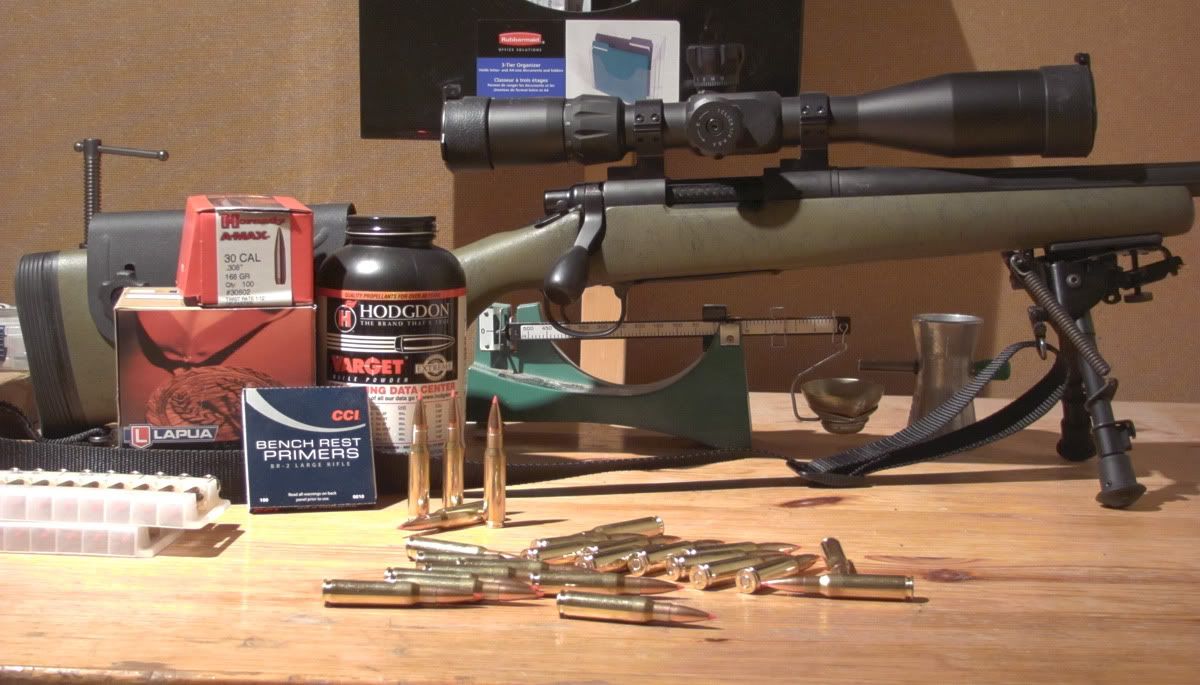

Lapua brass... it's a beautiful thing :D
Lapua Brass
CCI BR2 Primers
46gr Varget
168gr Hornady A-Max
2.810 OAL
I've loaded up some workup loads (though I probably don't need them) to 46gr and loaded 25rnds at max.
I then loaded up 9rnds for the OCW method of load testing. 3@ 45.4gr 3@ 45.7gr and 3@ 46.0gr
I'm thinking about loading up 20 for the ladder method but we'll see how OCW works first.

that looks frikin awesome ! what a cool photo...
BTW your scale zero could be adjusted just a little ;)

Wally I m curious if you have had a chance yet to re-load that brass. Are the primer pockets still snug? The reason I ask is that your loads sound fairly hot, based on my own loading experiences.
I mostly use Lapua brass, with 45.5 grains of Varget with a Lapua 154 and about 46.3 grains of Varget with a Sierra 155 (#2155), both seated to 2.810"-2.840" territory. The Sierra load is decently hot and quite uniform (thrown powder charges work well at 1000 yards), the Lapua load is medium-hot (I have not yet figured out how to get hot loads with the Lapua 154s to shoot accurately and uniformly).
Nice to see that your ammo is showing good promise (~1/2" groups). Let us know how things develop as you proceed (average group size for a number of groups, muzzle velocity and spread, etc). Have fun!!
Nope, not yet. Figure I might as well mess around with some loads while fire forming the box of 100 I bought before I start reloading it. I'm not seeing any excessive pressure signs. All looks well so far. I won't push it over 46gr of varget behind a 168 though. It's a slightly compressed load and that's exactly how it's listed on the Hodgdon website.
That load does sound a bit hot. I used to shoot 43.8gr Varget behind the 168 SMK which shot great. I usually end up well below max with most of my reloading, probably because when I find the 1st good charge I just tweak it from there. You may have hit that "upper node" though. Just monitor the brass, it will tell you what you need you know.
