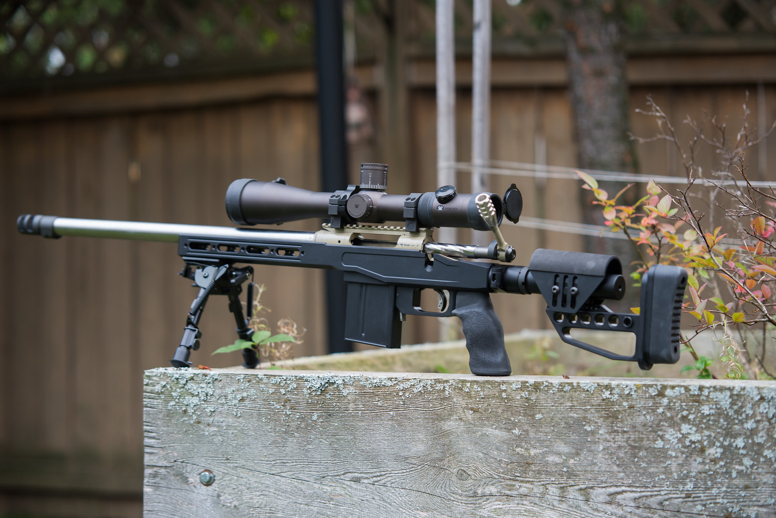

I just put a Savage 10 FCP in a MDT LSS chassis and so far, so good. The fit of the chassis was great and was as easy as pie to install. I topped mine with a Sightron 4-20 x 50 STAC with a MOA reticle. It is a .223 so this scope is more than enough. So far my hand loads are averaging 1/2 MOA but hopefully they will get a bit tighter with more development and if I can do my part.
I picked the Savage because I can build it myself, swap barrels in the future, etc. I went with .223 as reloading components are readily available and I can learn the basics and get more trigger time at a lower cost. The accu trigger is nice but a bit on the heavy side for a bench setup. A spring swap/mod is in my future.

Ok, well, I have decided to go for the Savage action that I have.
So far this is what I have:
Savage 10 action
MDT LSS-XL chassis
Magpul PRS buttstock
Millett LRS 6-24x 56 scope
