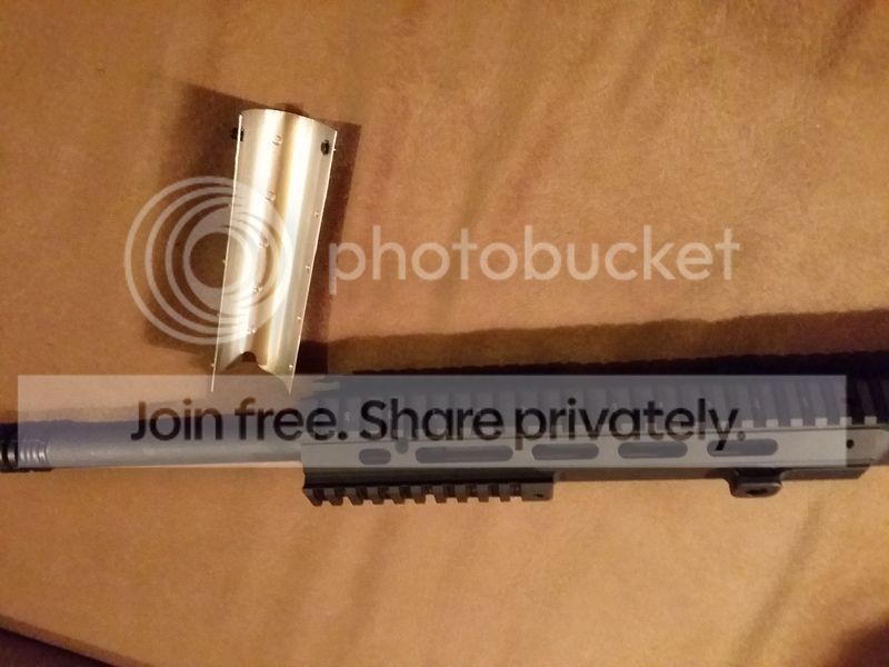

I used some wooden swab sticks. It popped right out without much trouble. I've shaped it back into form. But is there any reason I need to install it? I don't anticipate the barrel ever getting hot enough to need it.
Again, thanks for the tips.

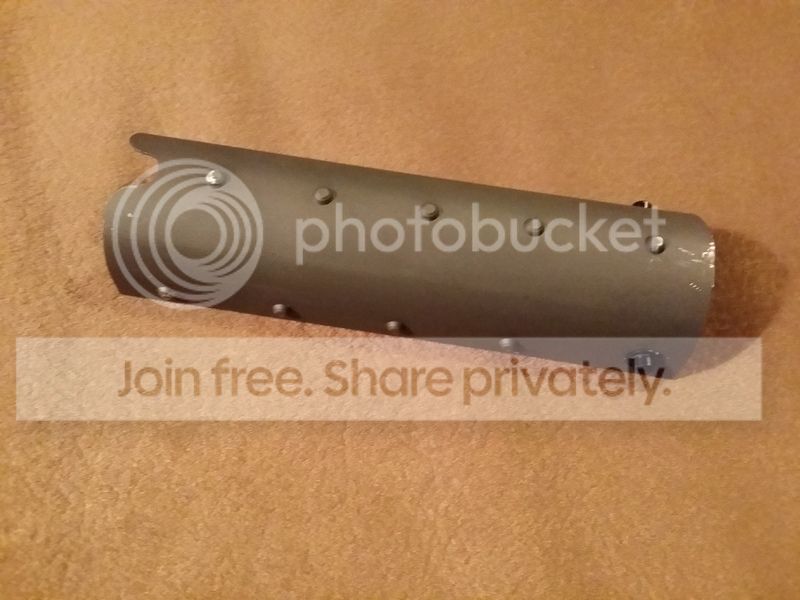

The offending piece. The the marks on the bottom of it are not from me.
Yes there should be. This isn't even one of the "belm" uppers.

I popped it back into place. No rattle at all now.
