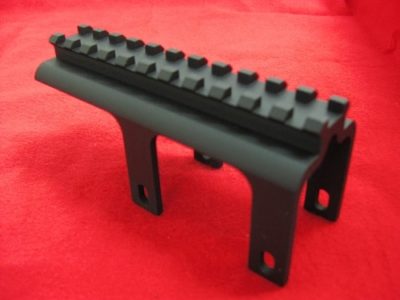

I'm eyeing up the JB-TEK mount @ murrays gunsmithing for my bubba SKS. they are made of 6061 T6 aluminum and are fixed with 4 8-40 screws. however i cant seems to find any user reviews on it, does anybody here have any experience with this mount? the info would be greatly appreciated.
my plan is to rock a aimpoint PRO with a A.R.M.S. #22M68 low mount . i feel this will be a relatively good setup for quicker target acquisition and low light shots. Also hopefully not having to worry about my zero shifting like it has with the other none drill and tap mounts.
potential pros: rigid, 4 points of contact, short, holds zero, see through for iron sights, and can still use stripper clips.
cons: drill tap mount, removal of mount to service the bolt, bolt carrier, spring, and dust cover.

asomer: i wouldnt go with jb-tek mount. holes on the mount are elongated so when the screws become loose the mount will move also not a big fan of complete removal just to do field stripping.

I noticed that about the mount aswell. Maybe i can order one without the elongated holes and just drill and tap them myself.

I went with a fullsize magwedge rail on my SKS so I could put a full size scope on it if I decided to (currently running a red dot).
If I was to buy something smaller, I'd go with one of the ones that replaces the rear sight with a chunk of rail. Something like this: https://www.badacetactical.com/products/sks-low-profile-ndt-red-dot-mount-with-back-up-sight
I had that mount aswell. Wasnt very ridgid and there was a massive zero shift after the recoil of a few shots. Money wasted imho.

if i was gonna drill then crazy ivan sounds better, you are only drilling 3 holes for the rail, all on one side and easier to remove two screws on the mount for field stripping but you might havta cut pieces off the wood. similar but more expensive is the zolot.
but i dont like to drill so i've tried scout mount, barrel mount, top cover and they all failed. best but not perfect im current using is the magwedge type rail, lol.
Well that just makes me happier that I went with the fullsize rail.
Magwedge makes a rail with a cutout to use stripper clips if you're looking for those to still be usable.
I had both types of that rail and they both failed me. The one with cutout for the stripper clips had the worst performance.
How did they fail you?
From what i observed is that there was to much flex/play at the rear leaf sight connection (front of the rail), and to much of a gap at the rear where it connects at the dust cover. The recoil would move the mount enough and and not return to the same spot after recoil thus the point of inpact would shift.
Also i think the thinness of the mount combined with the long gap inbetween the points of contact didnt help with ridgidty either.
If a guy was able to create a friction fit with the bottom of the mount and the top of the dust cover, and also be able to elminate the play at the rear leaf sight connection then the mount could possibly be alot more solid and reliable.
At first i thought it was my aimpoint and or the pic rail connector was loose, but it wasnt. It holds zero on my bolt actions that have pics rails.
Were you using the kwikpin, or the bolt to secure it at the rear? Mine feels pretty rock solid using the bolt on the rear of the mount once its tightened down, there is definitely some play with the kwikpin or if the bolt isn't tight though.
Yes i tried the kwikpin 1st then the bolt. The bolt seemed more secure but still didnt help.

I was rocking the mounts on my new old stock chicom type56 sks. Maybe the mounts were just to loose of a tollerance for my rifle at the rear sight and/or dust cover points, lending to too much inconsistent movement after recoil.
The smith i showed it to commented on the excessive movement at rear sight connection aswell, which helped in my decision to try and find a better solution.
