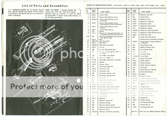

I'm a little dumbfounded, I can't seem to remove the plug on my Model 20 12 gauge. I can only load 2 shells.:confused: Can anyone help me out?

Unhelpful comments aside here are the instructions from the manual. What you seek is in bold part way down. If you desire a copy of the handout that came with the shotgun send me a PM and I will scan it into a PDF file and get it to you.

PLUGGING MAGAZINE FOR 3 SHOTS: Remove magazine band screw. Move magazine band to one side. (See Figure 5 and 6). Remove both magazine tube locking screws while holding magazine cap firmly. Remove magazine cap being careful to hold back magazine spring which is under tension. Insert wooden plug and reassemble. This reduces magazine capacity to only 2 shells with one shell in the chamber, allowing 3 shells in gun to comply with game laws of certain states.
DISASSEMBLY ()
TO REMOVE TRIGGER ASSEMBLY: With pencil point or small screw driver push out trigger lock pin from right to left side of receiver as in Figure 8. Lift rear part of trigger guard bow until projection of guard clears stock; then pull up and to the rear as in Figure 9.
CARTRIDGE STOP, RIGHT HAND: Disengage right hand cartridge stop from round slot in receiver wall and lift out of receiver.
ACTION SLIDE: Move fore•end rearward until all shoulders of slide are centered in the square cuts in receiver. Then while pulling slide upward move fore•end fully forward. Action bar is now free from slide. Hold slide up, make sure it is disengaged from breech block by moving breech block forward and lift slide out of receiver. (See Figure 10).
CARRIER AND BREECH BOLT: Push fore•end. to rear and slide breech bolt forward inside receiver. Using cartridge stop as tool, disengage the right side of the carrier from hole in receiver. Then disengage left side, and lift carrier out of receiver as in Figure 11. With fore• end forward, slide breech bolt fully to the rear, and holding it at the rear, lift up and out of receiver as in Figure 12.
1. BREECH BOLT: With round side of breech bolt facing receiver opening and with extractors forward, insert into receiver bottom and slide forward.
2. CARRIER: Move fore-end fully to the rear, grasp front and sides of carrier as in Figure 13, flat side up, slightly squeeze carrier sides slightly, and engage hinge ends in proper holes in receiver. Raise front end of the carrier, then lower to rest over breech bolt.
3. SLIDE: Move breech bolt to the rear, centered in square cuts in receiver. Move fore-end rear• ward until action bar hook is slightly back of the forward squa•re cut in receiver, place slide over receiver cuts and drop into receiver. (Make sure action bar hook has engaged the corresponding cut in slide).
4. CARTRIDGE STOP, R. H.: Insert right hand cartridge stop, with round stud slide into stud open ing in receiver.
S. TRIGGER ASSEMBLY: With fore• end fully forward and the hammer of the trigger assembly in a cocked position, hold cartridge stop flush with receiver walls, insert front end of trigger guard with guide prongs fitting into guide grooves in receiver walls, push forward and down. (Se'e Figure 14).
6. TRIGGER GUARD LOCK PIN: Push small end of pin into receiver from left to right. (Before attempting to drive in pin, carefully align trigger guard until pin hole shows clear passage).
