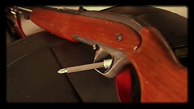

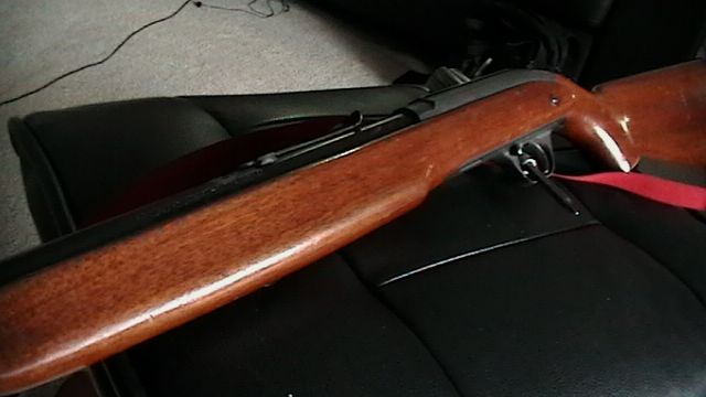

I just picked up a JC Higgins model 31, a deal I couldn't pass up.... Has anyone worked or owns one of these? Just wondering what kind of info can you share about this interesting .22 cal. Its going to need a lot of work to make it a shooter, so any help would be great.

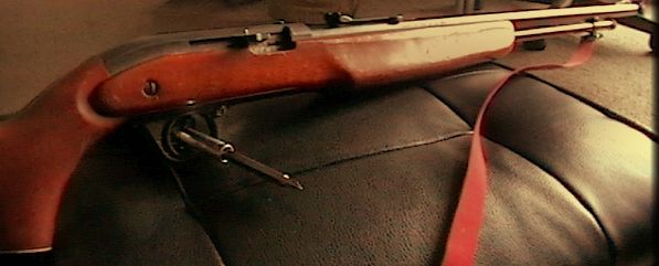

Sling on a spool in the butt stock? Fore end wood forms cheeks on either side of the butt?

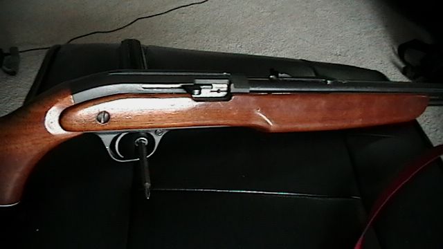

Here's a Model 30 I picked up on a trade. I'm really impressed by the quality thus far. I haven't had a chance to shoot it, but Tues will remedy that. I was surprised to see it has a jeweled bolt.
Actually the retractable sling isn't retracting. The spring is broken apparently. If anyone has a line on a replacement, let me know.
Well Trev, its in rough shape. The firing pin is broke, and doesn't seem to be cycling properly. But I haven't had time to take it apart and look, yet.
It look just like the the pictures that Kirk put up.
