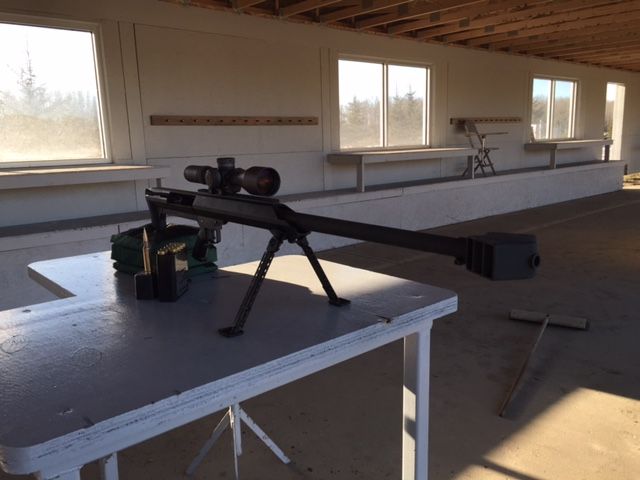

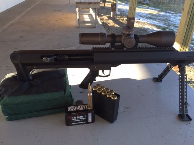

Barrett M99 in 416 with Vortex Razor HD2 4.5-27x56. I am using a 34mm Nightforce Unimount for a total of 47moa tilt.

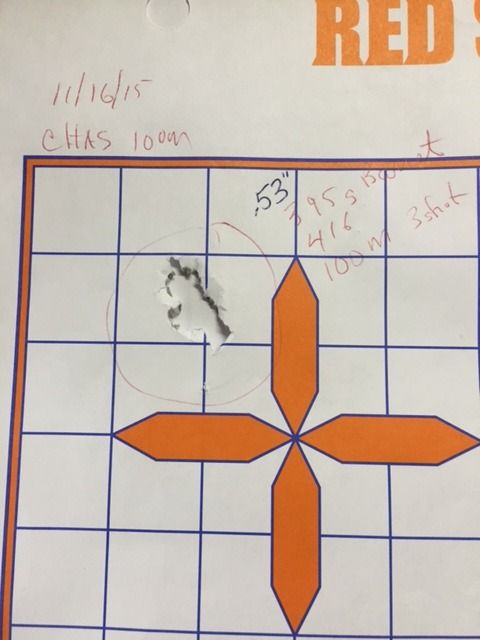

Tried some of the Barrett 395g ammo. Very good factory ammo. After wasting a few rounds to zero the Razor HD I got this group.
At $8 a round, 3 shot groups are fine.

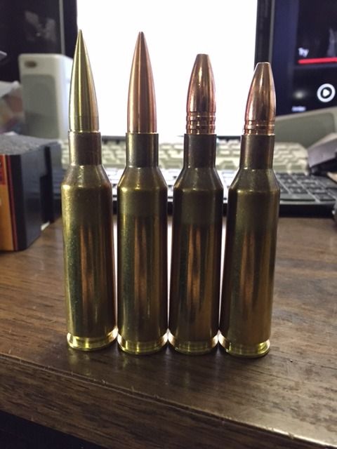

Next I tried out a few rounds of reloads. Tried some of the 446g projectiles from Wolverine made by Cutting Edge. They shot very poorly about 2moa. Not very good for a projectile that costs $3.20. Used 190g of US869 with a COL of 4.53". Anyone have any luck with these projectiles?
Next I tried a few 416 calibre 350g Barnes TSX FB projectiles made for big game. They actually shot about 1 moa so worth doing some more testing as they cost a little over $1 each. Not sure of the seating depth so need to make a test cartridge for the Hornady OAL gauge.

Nice gun. The factory ammo sure shoots well. I understand and will permit the 3 shot group. haha.

The Barrett projectiles are solid brass made on CNC machines. So are the ones from Cutting Edge. The TSX is all copper. I only want to use the TSX to get more trigger time on the gun. BC is terrible on the TSX but for a $1. The TSX seems to shoot about an inch higher than the expensive Barrett rounds at 100m.
I do want to try out the 450g Hornady projectiles.
