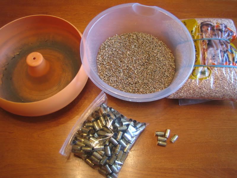

Tumbling:
Over the weekend while watching Cops on TV and polishing off a 6-pack I managed to sort about 2000 cases... thats 333.3 cases per beer I suggest new reloaders stick to this pace.
I decided to tumble 350 Winchester headstamped cases as I seemed to have alot of these and Winchester Powder is what I'll be charging them with. Of the 350 about 20-30 hit the "Bad Brass" bag which I will return to AMA's scrap brass bucket.
I tumbled them in approx 1lb of corn cob media with 1.5 cap fulls' of Nu Finish Polish for approx 3 hours... I came up with these specs by watching Youtube and searching suggested tumbling recipies on CGN...
I am happy with the results (considering many of these were heavily tarnished having spent a few days on the outdoor range ground)
I will be sorting through them again now that they are polished to remove any bad apples that missed my first inspection.
Here's a picture:
1) Note how much carbon and lead residue is on the bowl after just one tumble... this is why I highly suggest (thanks Sean for the tip) to WEAR GLOVES AND A MASK throughout this process... lead poisoning can turn your swimmers into sinkers and nobody wants that.
2) Discoloration of the media apparent... I did my best to combat this by using cut up USED dryer sheets which supposedly helps keep your media clean... unfortunately I cheaped out and bought dollar store dryer sheets and they fell apart more than anything... Bounty - you just made the pick list.
The "residue" you see is mostly dust from the corncob breaking down. The dryer sheet will help a bit to keep the dust from going airborne but you will still get dust and it will not keep your media clean.
The Discoloration in the media means it's doing its job by "polishing" the brass. Put some brass polish on a cloth and rub a case with it and notice how quickly the cloth turns black where you rub the case......Walnut/Corncob Media = Cloth.
I put a fresh batch of media in my tumbler with some mag polish and left it on over night. When I get up the next morning the fresh media had turned grey/black from the polishing process.
Put a couple of table spoons of varsol in the media when it gets dirty. Gives a nice lift to the media and to oneself when one opens the tumbler. Learn't that here.
