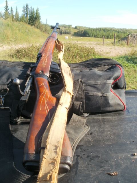

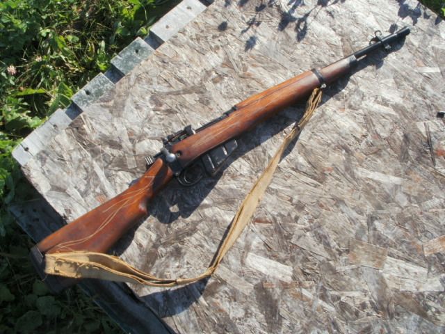

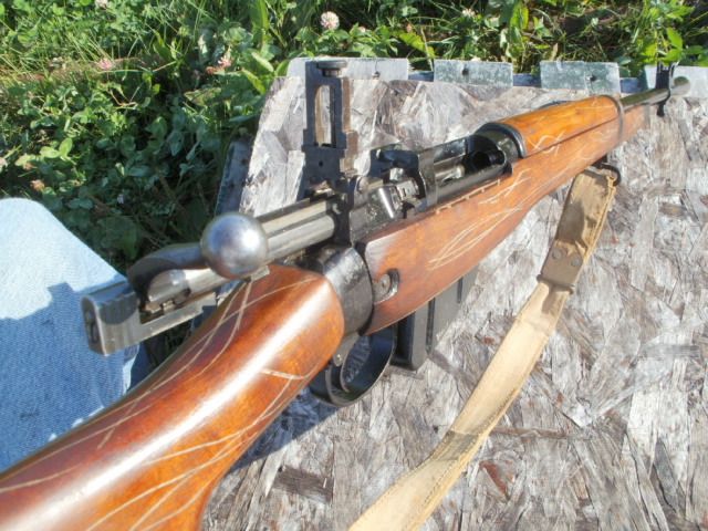

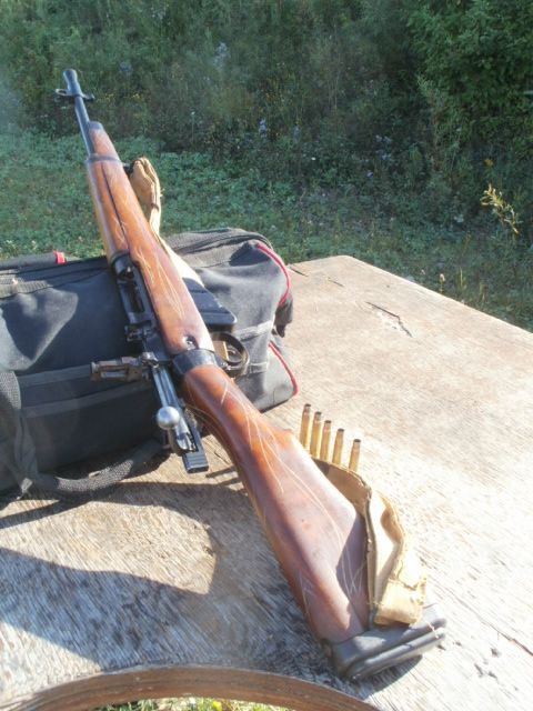

Well finally got her out.
Here is an update for anyone that was still watching.
This is after meticulous cleaning. Full dissassembly and many hours of slow and steady cleaning with steel wool and rotary wire brush bit.
The bore cleaned up after shooting it with plenty of shine left and razor sharp rifling. There is some slight pitting from the surface rust between the lands but it clearly still shoots!
The painting on the stock is actually from the wifes grandfather when he used the rifle for moose hunting before he died many years ago. He was a Sioux Band Chief.
Here's some pics:

Used the ladder sight slightly between the 200 minimum mark and bottomed out.
Ammo was Soft Point Federal 180gr's.
I couldn't produce anything even worth taking a photo of using the battle sight, it's far too open to get a consistent hold. The front blades on these rifles are very thin lending to ease of consistency on POA with the tiny ladder hole I find.
The nice 1" wide piece of hard-as-steel rubber pad makes shooting it very painful on the shoulder though! 20 rounds that day was enough for me for a while lol
