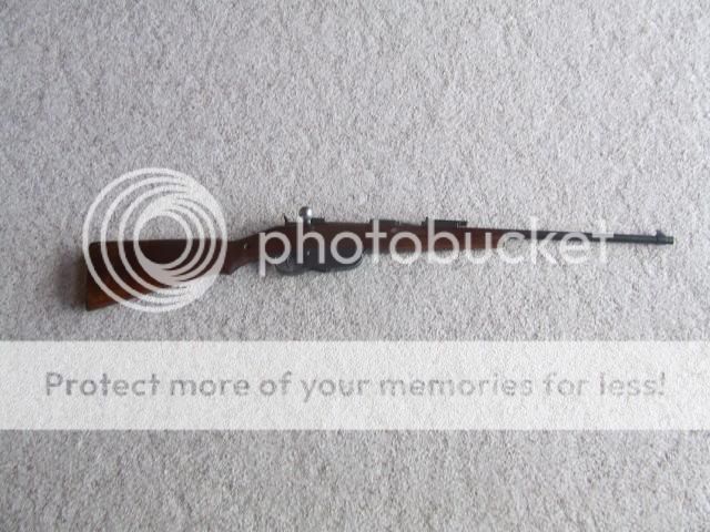

Just added a straight pull steyr m.95 caebine to the safe!

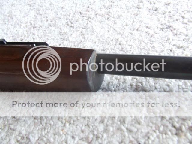

Dont fret!!,intact stocks ARE out there. Worst case senario if needed is there is a company in calgary the does stock duplicating. If you want to go that route,I could drop my stock off as a tempate. As I have both a 95/30 like yours and a M95 Stutzen(correct as built Carbine). Does your bolt head retract when you remove it from the action, many do and there is a trick to keep it from doing so.
