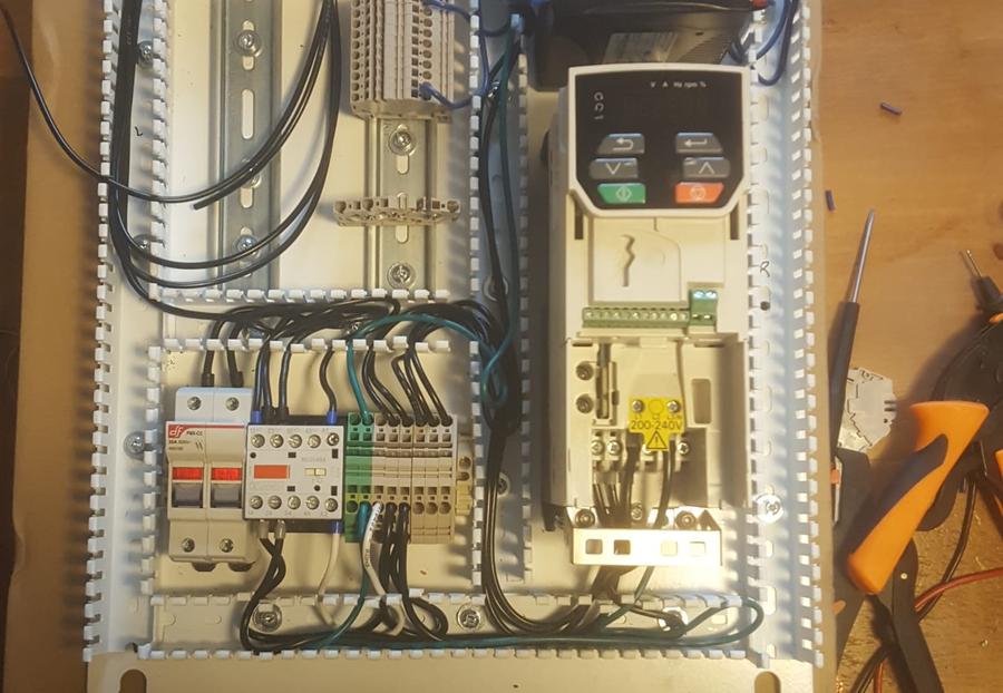

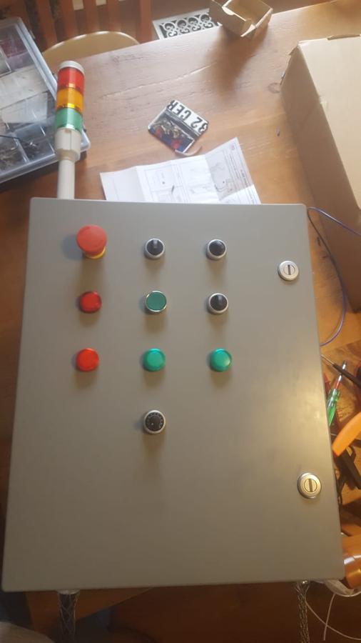

Well things are certainly moving along here at a fairly brisk pace. I am now spending currently most of my time in front of a computer doing design work on machines. I have built a couple more pieces of equipment and am getting more efficient at selecting pre-manufactured components and assembling them into a machine that does what I want. I am still contending with a bit of trial and error, and some dead ends.
I have learned that if I budget $10,000 for a project, then add at least a 250% cushion to it. Just like the government. It seems I am on a bit of a pendulum, for trying to find the balance between performance and cost when building equipment. I want the "best" just so I know "X" component won't be a problem, then I realize that if I am to sell that machine, I need to come up with a more budget friendly replacement for things like bearings, and steel selection.
I am also streamlining parts of the process for manufacturing, getting parts water jet and wire EDM cut where appropriate. I am trying to establish "acceptable" tolerances on machines, hence I can move more things over to water jet to speed it up and reduce the cost. Heat treating of metals has been an interesting experience. Trying to research the correct hardness to make parts, the correct processes. Then also if cryogenic treatment will be of benefit. I have found some very helpful people in the industry who will answer all my questions. It took some time to develop those relationships so that people would actually talk to me, but once you start showing them plans and get them interested in what you do, then they became immensely helpful.

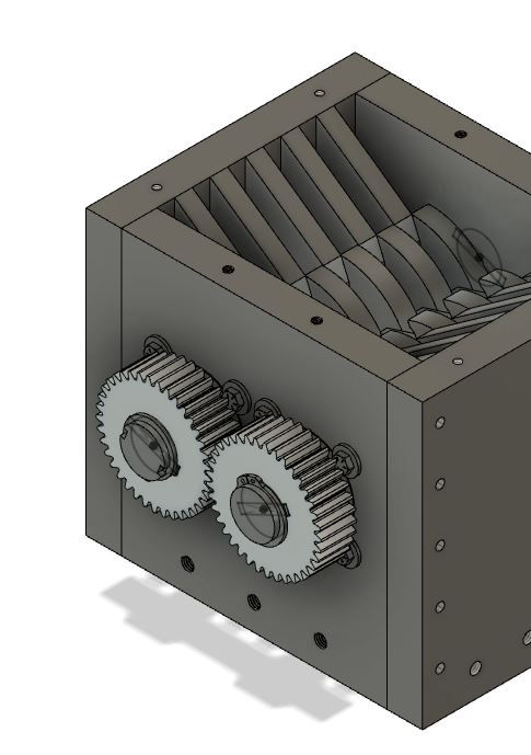

I am beginning construction of my shredder MK. 3. Math says it will be approximately twice as strong as my previous version, while using the power provided to it more efficiently.
What is in the works currently?
Well as above, MK. 3 shredder will be completed construction here early in the new year. Next up is I have designed a machine that will strip aluminum and garbage out of brass at high rates of speed, in the area of 250 - 500lbs per hour throughput. I am also currently working on a project that is a strictly military application and is pretty neat, but also I can't really talk about it too much until the patent paperwork comes back.

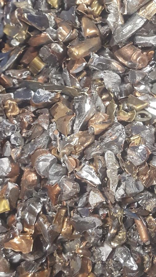

Brass de-milling - destruction of waste brass - turns it into a product suitable for scrap to extract full value
  • Machine footprint of approximately 24" x 36"
  • Conforms with UNODA IATG 10.10 for the destruction of small arms ammunition to render safe any products being sent to the commodity markets.

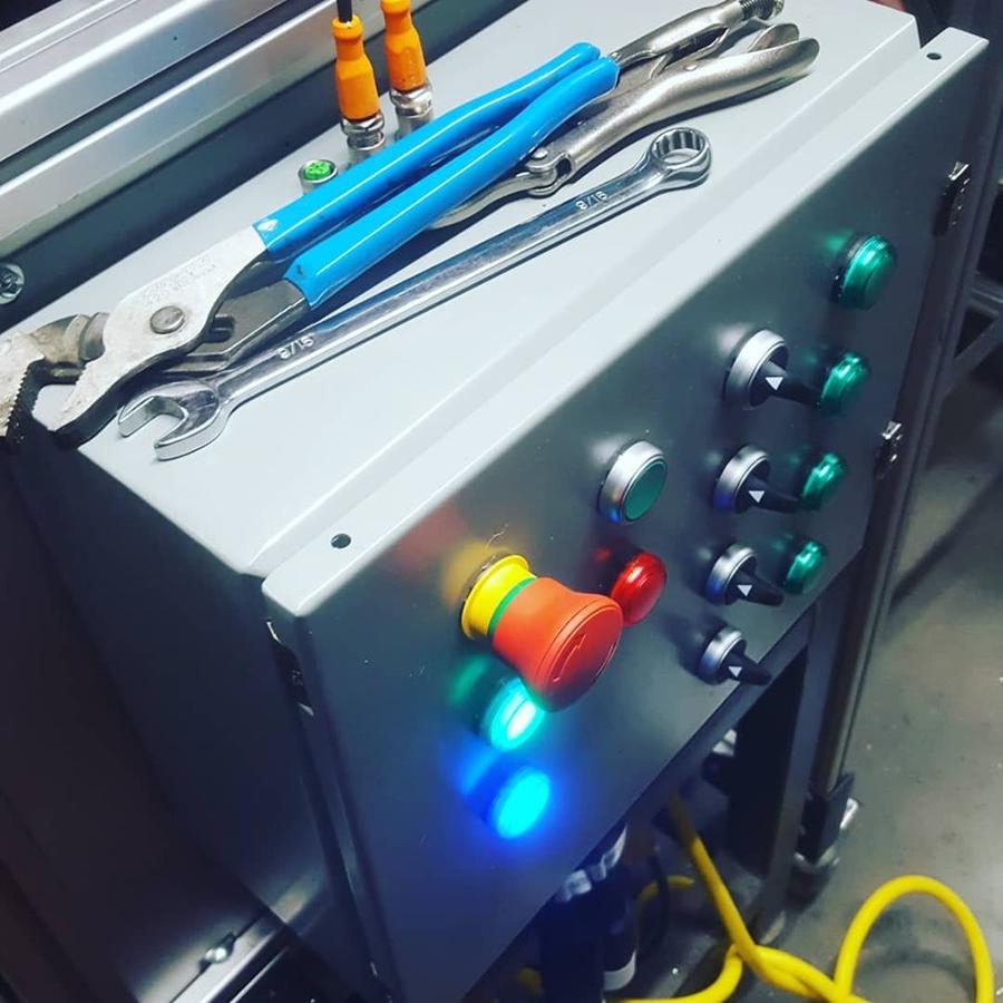

Our sorting line controller is now in service. This should make us about 80% more efficient. I am thinking probably will sort in excess of 2,500 pounds per day now.

Too many buttons, you need to start using an HMI with that plc. You should also add an eWON to all your systems, gives you vpn remote access and report generating.
VPN is great for remote access so you can trouble shoot before sending out a technician.
You can set it up to send you any alarms on the machine so you have an answer by the time the customer phones you.
There are actually only two "buttons" the rest are just status LED as I watch the machine remotely over camera. The rocker switches are just for auto - off - manual for machines in system.
Next machine will have an lcd HMI however the cost was an issue. As a PLC with a 7" panel is $1,200 with taxes vs the $500 I paid for the PLC, expansion module, led, buttons and switches.
I have not gone into eWon, I have no idea even where to start. I have data logging on the actual PLC and I can see cycles, cycle time, and lifetime hours for each piece of equipment. If I had a technician who did repairs and maintenance I could definitely see the value of something like that, however it's just me who does the service on my equipment, hence currently being able to vpn in is of limited value. If loaders in the USA want these, I may have to look at that so I can log in and do programming changes if required.
