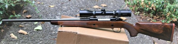

I would avoid mounts that require bases. The Sako tapered dovetail eliminates the need for bases, and rings that slide directly onto the dovetail are the best way to go in my opinion. Adding bases is redundant and may position the scope higher than desired. The suggestion by 4fifty8 of the Leupold Sako ring mounts is a good one. Another suggestion is the Sako Ring Mounts (not the 2-piece Optilock mounts), which are available (Stoeger, Reliable) in both 1” and 30 mm. Just to be clear, these are rings that attach directly to the Sako dovetail and don’t use bases. I have these Sako ring mounts on my Sako 85, shown below, and like them. They are more nicely finished than the Leupold version, are 4-screw rings as opposed to the 2-screw Leupolds, and use the rubber spherical sleeve to avoid scratching the scope. Pic below. So either the Leupold or Sako ring mounts would be great for the 30 mm Leupold scope you mention (as well as a 1” scope). The vintage (long out of production) Sako mounts mentioned by conor_90 are really excellent, but are available only in 1”. They are hard to find, but can be found sometimes on used sites. In my opinion, the Sako Optilock 2-piece mounts that use bases as well as rings are less desirable. They tend to put the scope higher than most want it and are heavier than the ring mounts mentioned above.

View attachment 865943View attachment 865953
