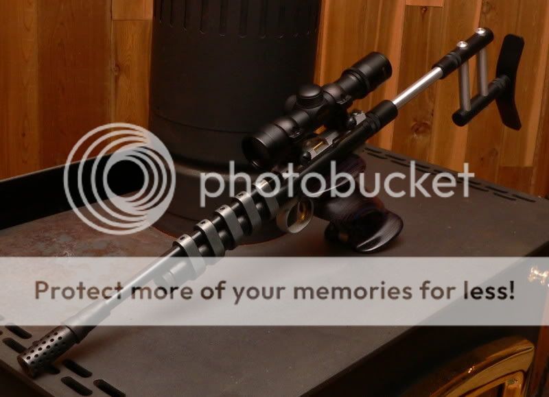

Levi Garret posted pics of his customized 2240 over on the canadian airgun forum if your interested. Looks like he went all out, must of cost him a pretty penny.
ARDNEH
Congrats on the coolest 2240 Ive seen. Is the stock DIY?
Looks like your using a Crooked barn breech? Havent seen one of those for a while.

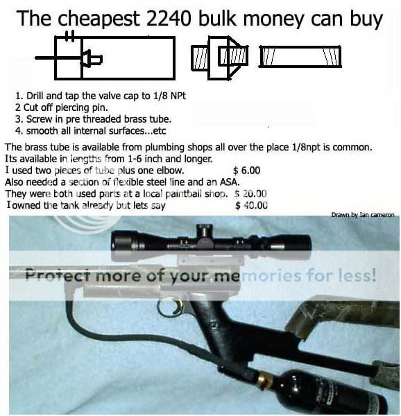

Thought i would share here is what my crooked barn looked like. it had a shot shell breech and could fire a .380 round ball. Gun is bulked with the line tapped directly to the end of the valve with snipped piercing pin. I was addicted to building 2240s but not actually shooting them in the end. Ive customize and sold 5 and broke even the last one i built 4 months ago as a keeper untill a friend swapped me an in the box perfectly patina Crosman 150.
