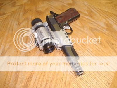

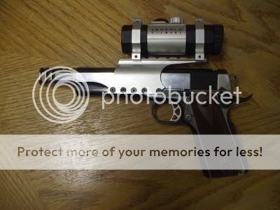

Well I had to see what one was like so I ordered one in .45 with the Armco touch and what a buy it is. Well worth the extra few bucks to have Gunnar go through it, shot 200 rounds through it with no problems what so ever.
I butchered it up good though, polished off the blueing on the sides to give it the eclipse look, turned out not bad, put a red dot sight and mount on it along with a compensator, match trigger, hammer, STI beaver tail and rosewood grips.
I really like it cause I am not scared of drilling holes or hammering on it when I need to on a 400 dollar gun.
An STI it ain't, but worth the money to hack up.:eek: :D
Here is some pics, they don't really show the polished sides very well but it looks better in person.

It actually works not bad, better than I thought. I would say it gets rid of about 50 % of the recoil.
A good barrel comp gets rid of probably 90 to 95% recoil, sometimes better than that.
But it was cheap so I like it.

Oh I don't know, I suppose around $ 750 to 800. I started with an Armco prepped gun at $449, some pieces and parts I had, some I bought new, some used.
It was just a project gun, I started with a Norinco cause I didn't want to mess up my STI's. The biggest reason I guess was to polish the sides and make an Eclipse looking gun, to see if I could do it and if it would turn out - it did.
I don't use it for competition, its just a plinker.
