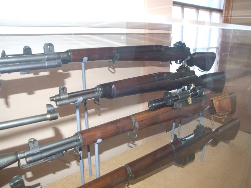

Heres some pics of the actual models from my trip to the second floor of the springfield armoury museum.
Its the second one from the top. They existed, so for rarity, they would bring a pretty penny. Hope this helps. Some were made in the field and some in springfield.
