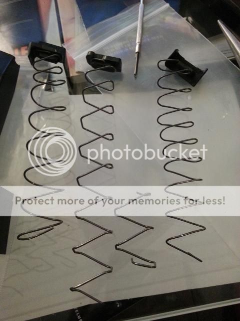

As a follow up, I went ahead and ordered a few extra mags from the US along with aftermarket springs and followers. A few observations:
- the US 10 round mags (left) have different springs and followers that actually connect and stay together. Notice the thicker coils and less of them. No probs loading 10 rounds there.
- the aftermarket spring (middle) also has thicker and less coils, and the follower is thinner to create even more space. After cutting the spare coils to fit the 10 round mags, No probs loading 10.. even easier than the US stock (can't load 11). I was able to load this setup into two of my Canadian mags and they seem to be working fine now... the third Can. mag seems to have out of spec outer dimensions as it needs to be pushed up into the pistol and doesn't drop freely... will try and warranty this one.
- the Canadian 10 round mag (right) has thinner wire with more coils and the follower just sits on top of the spring... doesn't connect.
