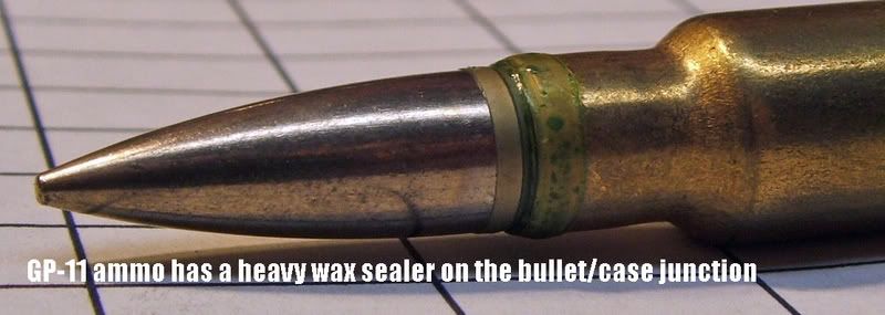

What method are you using to decap the GP11 case? I want to try, and I've seen a few different ways.. Water, RCBS tool, very small punch...
