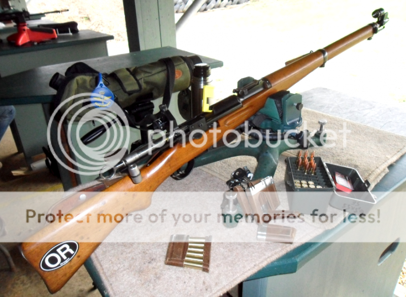

One of mine:

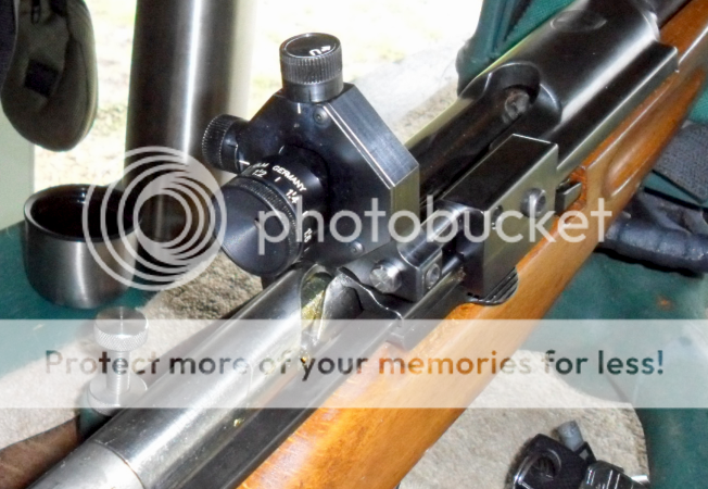

Not a ledge, but a sustantial machined-into-the-mount stop. You can see it clearly in diopter's excellent pic. Once you have your scope mounted on this, it will not move anywhere. Trust me, I have three SP mounts - all are made the way you'd expect the Swiss to make them if they lived in Kalispel Montana. The alloy used in the construction of two of them is half the weight of steel and with its deep surface-penetrating anodised finish, a good deal harder.
As I noted, I have three SP mounts - the old [up to 600m] diopter unit and foresight, the newer and highly spiffy P/S version [up to 1000m] - made of steel, and adjustable for eye relief, and the scope mount. For the purists, please note that the Swiss Federal Shooting Association fully authorises the use of the Swiss Products P/S diopter sight - something that took twelve years and a number of prototypes to achieve - none of the prototypes were ever returned, BTW. This is something that no other similar sight made outside Switzerland has ever managed to achieve.
If diopter is feeling charitable, he might post the pics of this new sight on my K31.

Who? Me? Charitable? Are ye draft, laddie?
