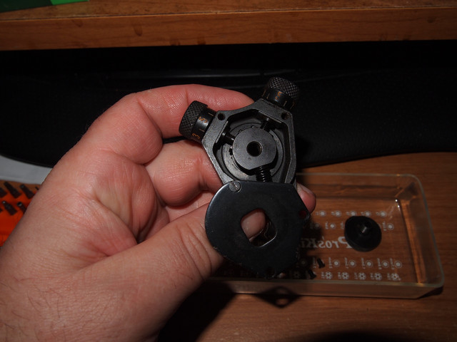

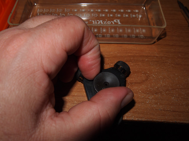

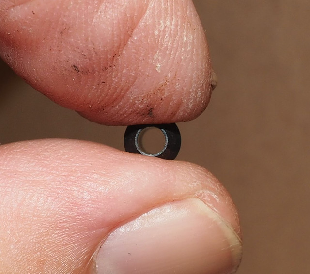

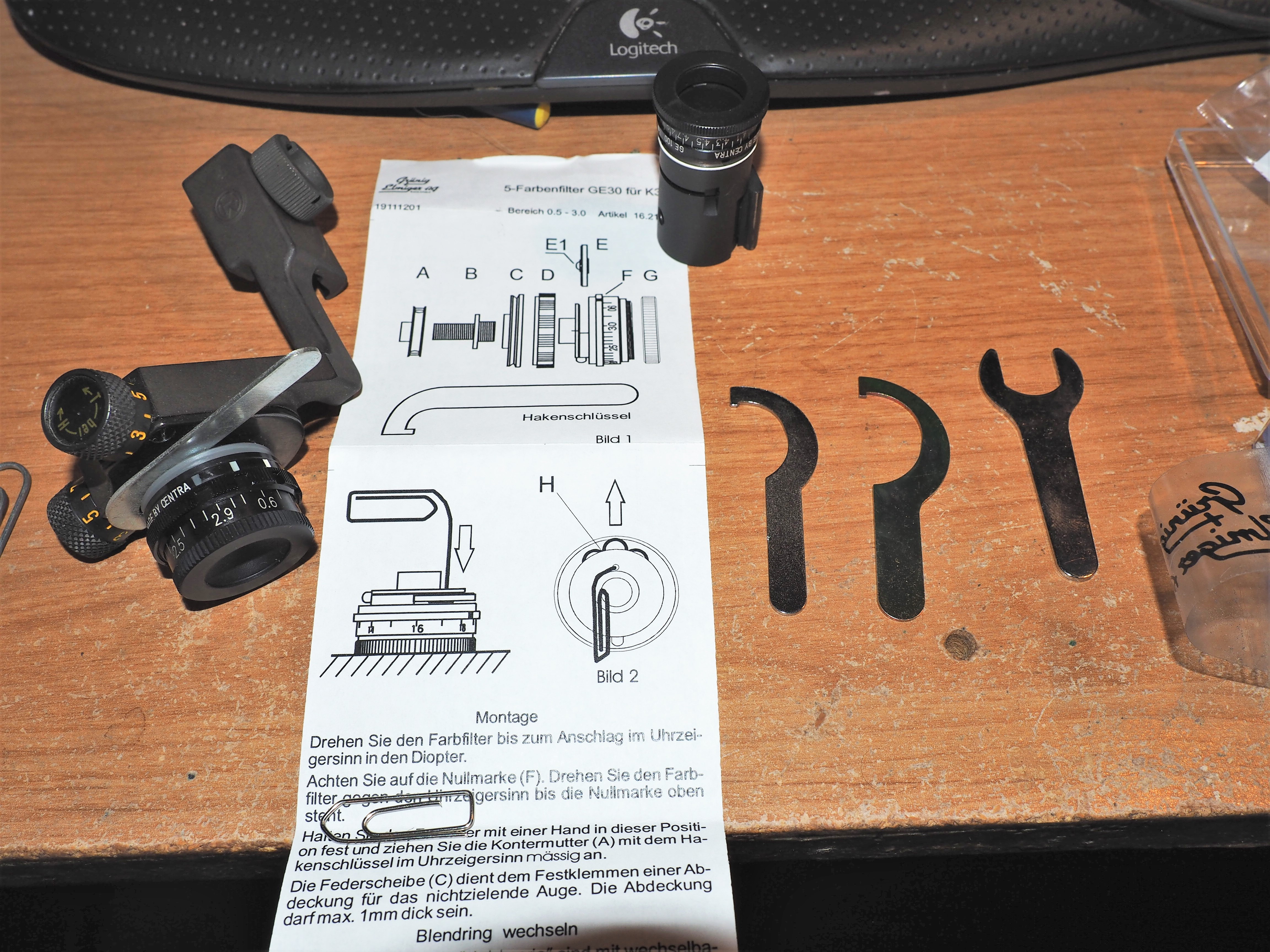

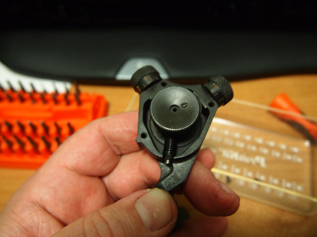

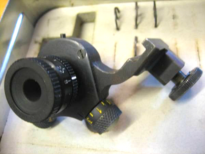

Starting off with the the more recent Grünig + Elmiger version of the Centra brand with a aperture range of 0.6 to 3.0mm.

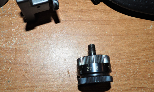

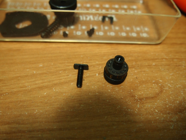

The diameter of the W&F iris thread is 5.5 x 0.5 mm versus the more common 9.5 x 1.0 mm as used in Anschutz and Gehmann sights and irises.

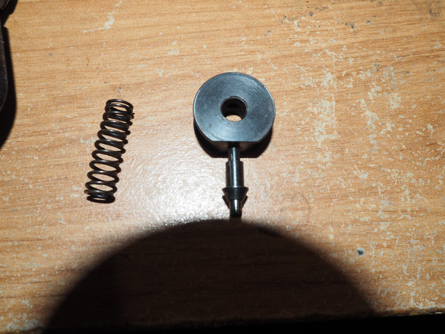

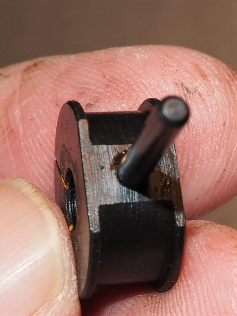

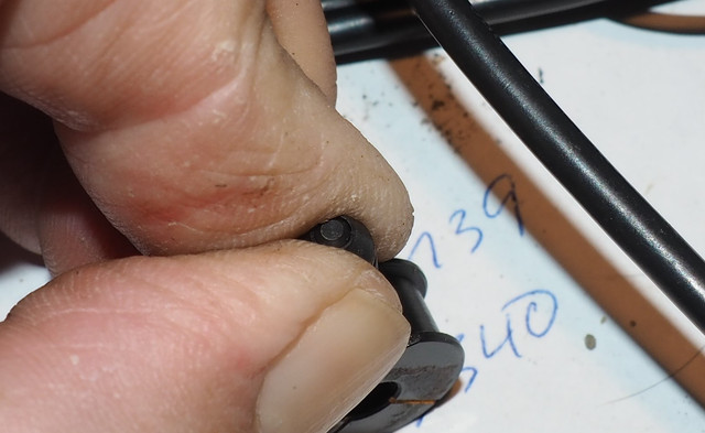

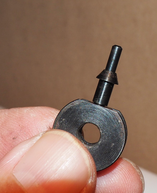

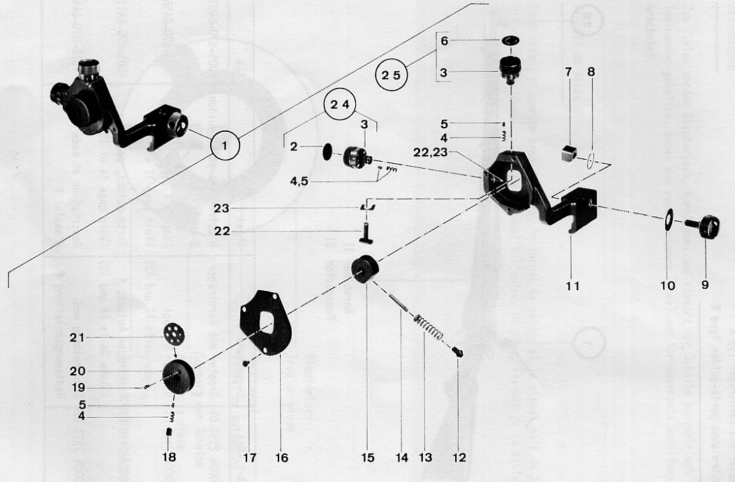

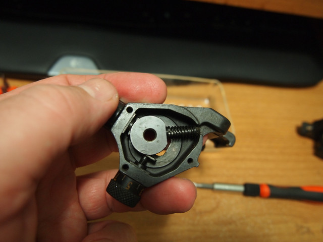

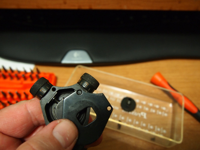

Part #14 is solid.
Part #12 is hollow.

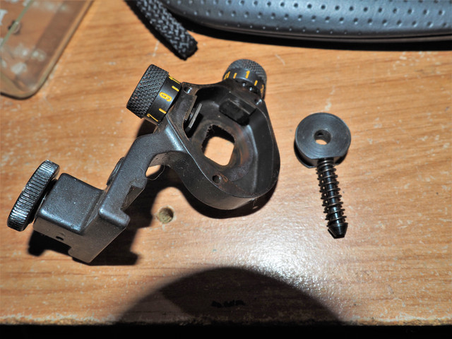

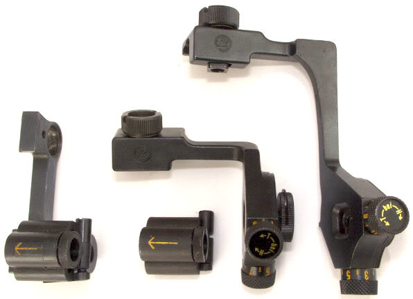

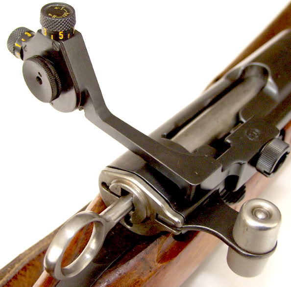

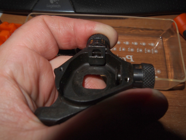

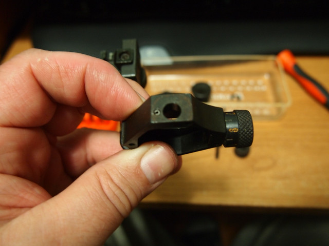

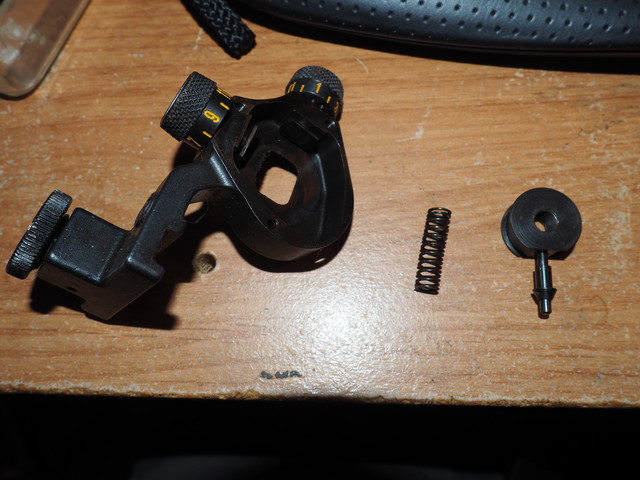

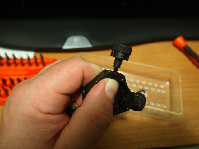

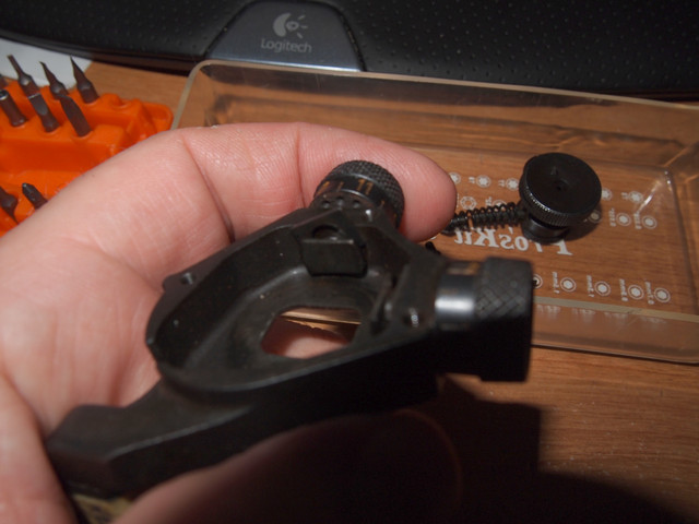

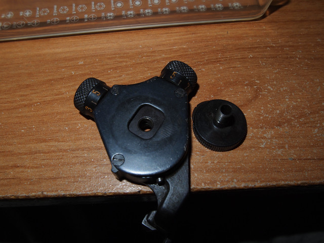

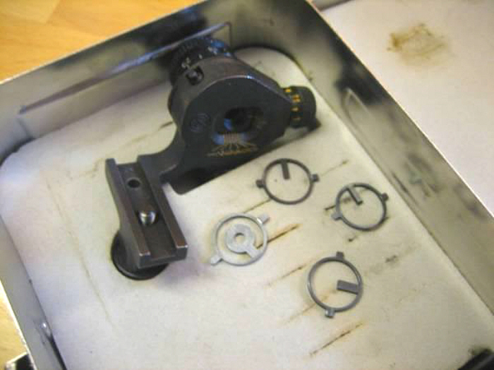

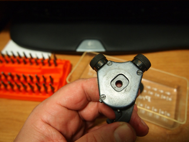

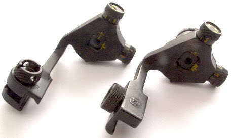

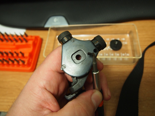

This one is an S type W&F diopter that fits into a purpose milled area on the left rear end of the receiver.
The K type fits into the thumb notch on the right side. Internal parts of both types are the same.

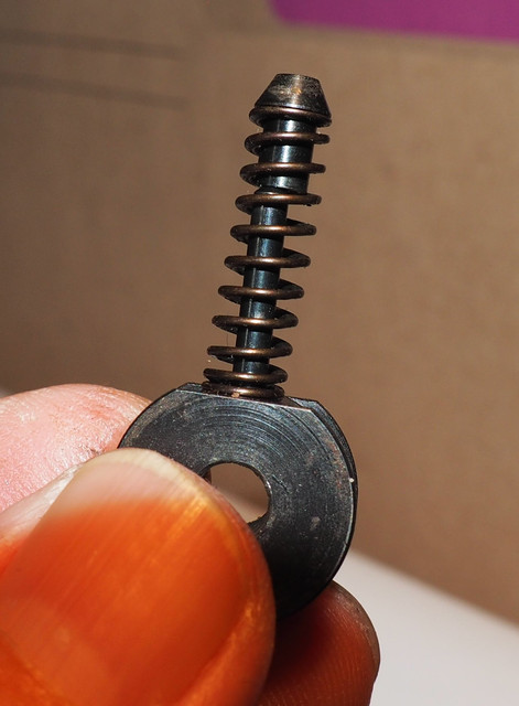

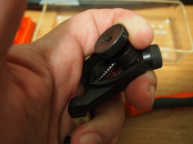

Part #14 sticking out of the housing

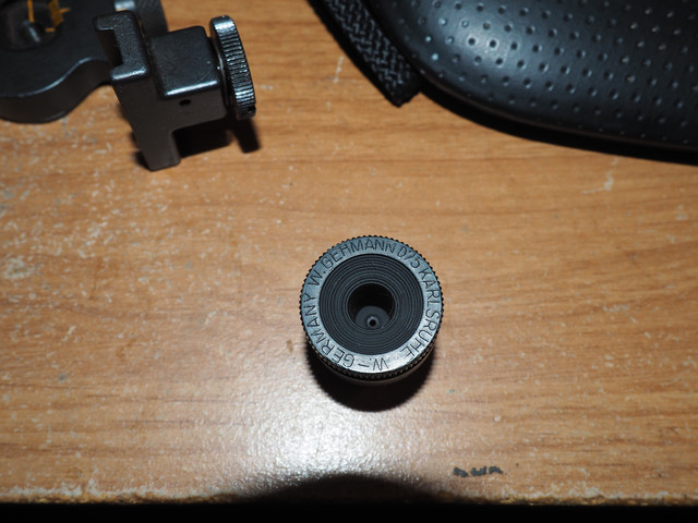

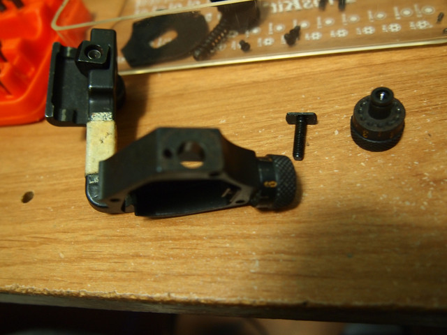

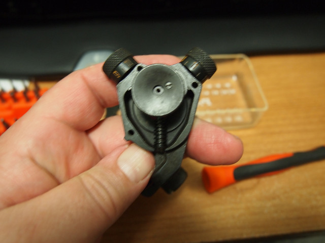

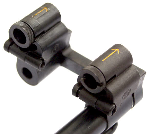

The first aftermarket replacement for the W&F disc iris was the Gehmann D75 iris that used a rubbery plastic instead of the disc or metal iris leaves..
They hardened after many years.

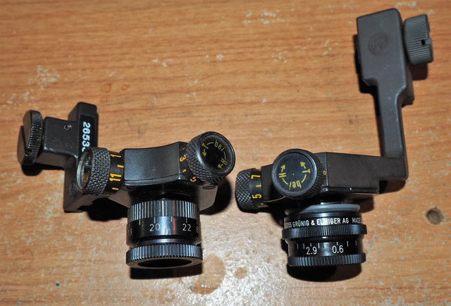

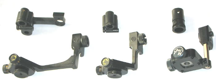

S type W&F diopter with Gehmann D75 on left and K type with one version of G+E(Centra) on right.
