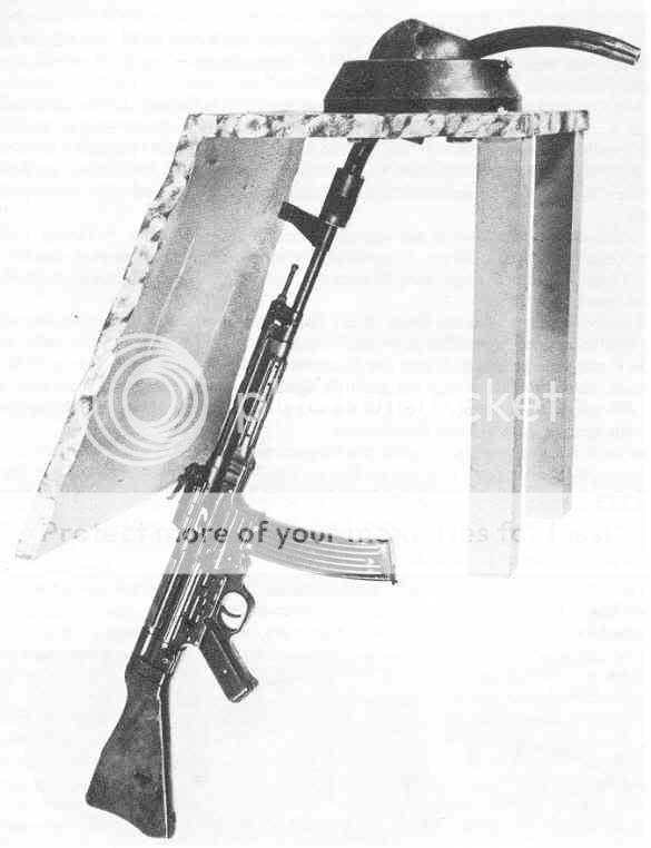

Krummlauf...
For those of you that didn't know, the krummlauf was a German invention that allowed the soldier to basically "shoot around the corner". It was a barrel extension bent at a 30+ degree angle. I believe it was designed for the STG44, but may have also been adapted to the K98.
