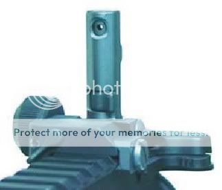

Well the Aimpoint was replaced in the SOPMOD kit - so now worries there
With the EOTECH (or Aimpoint) you just use the body as a big ghost ring and keep shooting till the threat is gone.
The locking mech was required by SOCOM as a lessons learned from the #40's spring has seized in the dust of Afghan and Iraq.
The lock mechanism is the same as KAC's flip front sight gasblock combo -- that has severed admirably on the USMC SAM -- and on my rifle
-- I have no issues manipulating it with flight gloves on.
<<<IMAGE DELETED BECAUSE IT WAS TOO HUGE!!!>>>
Leave it in the open position if you worried about it seizing.
Kevin,
Again, my observations are from an engineering standpoint and not a soldier's viewpoint as I'm not in the CF. That being said, I still don;t like the design. It looks overly complicated for the simple function it has to perform and looks prone to wear and breakage. Time will tell if my concerns are justified or not, but if I were running the KAC R&D team, that sight would NEVER leave the design shop with my PEO stamp on it and that's a fact
Re: Aimpoints being replaced in SOPMOD, yes, I agree the Eotech has "officially" supplanted it, but from what I've heard, the sales of AIMPOINT to the US forces has not slowed. Both Eotech and Aimpoint and Trijicon are making and selling thesesights to the US forces as fast as production will let them. I suspect that no matter what the standard SOPMOD kit is, there will be an Aimpoint substitute standard for some time to come and also it will likely be years before the aimpoints in the system are withdrawn from service, if ever. I should think the odds that field armorers will install the new KAC BUIS behind a few AIMPOINTS is 100% and then some
I also understand they were not happy with the ARMS once sand is introduced, but I've not heard that complaint about the KAC 300m nor the Matech which are both spring loaded sights. In fact only complaints I've heard about those sights are that the Matech is too heavy (subjective), that the arm retainer can wear out leaving the sight "permanently deployed" and that is has a fixed aperture and that the KAC's aperture reducer (a plastic insert) is too easily lost.
If US spec is calling for the new lock mechanism then I can understand its inclusion, but personally I think it's dumb to mandate it when only the 3rd substitute standard BUIS (currently the ARMS) seems to be missing it. But hey, what do I know about beurocracy?
My gloves comment was about the aperature selector flip anyhow, not the (IMHO useless) lock. I think a better design would have been a GG&G type aperture selector which is easily manipulated, or even better an A2 style flip on the end of the post.
As for the front sight, personally I like hte KISS method of just using the fixed front sight and getting used to part of it being visible in the optic. Oh well, if cowitnessed properly it shouldn't matter
