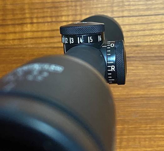

Mine went to the US, but they found the tube was actually damaged and suggested it be replaced. At that point it got a little interesting, as that work had to be done in Austria, and it was not work covered by warranty, so I was presented with a cost for the work, and return shipping, and had to decide to pay for it or not. In full disclosure, the whole thing (new scope tube, refinishing, new occular lens, AND new BDC, and shipping) came to over 600$s. By that point I was into this scope about what a used one undamaged would have cost me, so gave them my CC over the phone and waited. In all it was about two months, and besides the work to repair a chipped lens, and replace the tube, they were able to change the bullet drop cam that ZF 95s have. During a call with Swarovski USA I asked if they could tell me what the original was, and if I could get it swapped.
The original turned out to be #335-831, for 308Win 9,3g (144gr) FN SS77 (100-800m) 856 m/sec 2808 ft/sec
For 40 Euros they swapped it out to #335-2177, the 1000m 168gr for me.

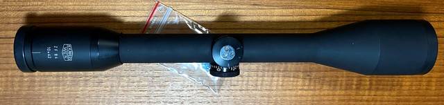

The scope came back with a new lens, new tube, and new finish, a matte coating, nothing like the original. The clarity is pretty much on par with Schmidt and Bender, very crisp and bright, and the reticle is crystal clear.
Compared to other fixed 10s, the ZF95 is pretty nice, and the glass seems very clear, like I say maybe just a bit below a Schmidt and Bender.

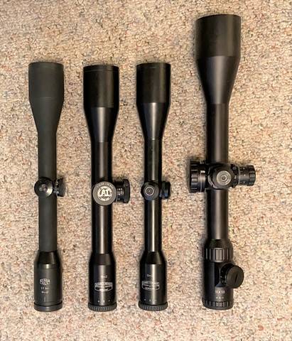

For comparison in size : old s&b PMii (AI marked 30, tube, 42mm objective), another 10X42 (1 inch tube) S&B, and a Millet 10X50.
Over the years I have had a lot of fixed 10s, mainly for tacticool and sentimental reasons. IOR, Bushnell, Falcon, S&B etc. My preference is still the S&B PMii line, of which I have two currently, plus this older AI one. At anytime a little googling will bring up a good half dozen current production models, and if you want used, there seems no end, including Swarovski, Hensoldt, Kahles, S&Bs, Sightron, Leupold, USO, etc etc.
