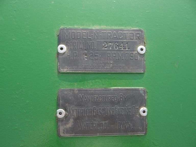

On another note it looks like the stock plate is likely from an 1920's tractor.

Thats funny, you found the plate. Thanks J
