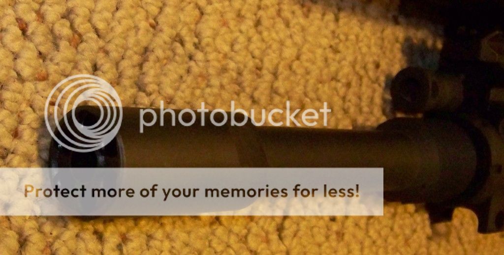

I had Dlask Arms put on a custom made Muzzel Brake and this also has had a positive effect on my grouping and the well being of my fellow shooters, at 18 1/2 inches it is a damn short barrel and the muzzle blast can be intimidating. If you're in a hurry you may want to choose someone else but I find his work is excellent and well worth waiting several months for. (Personal note, I have seen some posts on this forum about lack of communications from Dlask and I have found all my phone calls and e-mails have always been returned no later than the next day.)

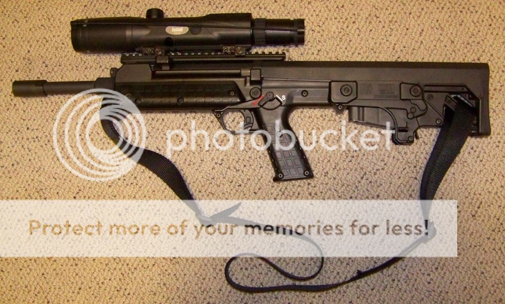

Maybe its a weird effect of the camera, but it looks in the first pic that the lower is flexed slightly toward the bottom of the pic but in the stripped pic the lower is flexed upwards??
can you confirm or deny such "Flex" in the lower?

The uper pic is completely straight, might be a illusion due to the 5 round mag. Once you disassemble the rifle the lower is in 2 piece and is attache with a pin so jt kove up and down, its like that so it easyer to disasemble and you don't have to completely disasemble the rifle to move the charging handle from side to side.

It is the fishey effect from the camera lense, I take the picture at a slight angle to give it the 3D aspect and at short distance this is the effect I see.
a tip to anybody who's interested in basic photography, when you're taking shots like this of equipment or objects, it is best to set the camera farther away and use the lens to magnify the subject. this way you can avoid or minimize the bowing as things extend out to the edge of the image. and of course if you want that ultra close up with the cool curving effect do the opposite.
