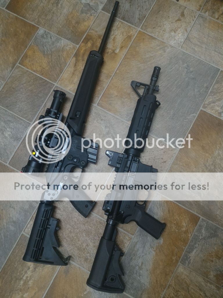

Build quality? It's Kel-Tec. It looks and feels and looks like a nerf gun. I was really turned off when I opened the box (as I knew I would be), but once I got the pistol grip on it and replaced the stock with a proper (take-off) AR stock it started to grow on me. The trigger feels like a sponge. Meh.
NOTE: Pistol Grip Stock
The Pistol grip stock comes with two height options:
1. A low, non-AR height (which allows the use of the factory sights, but feels like a shotgun.)
*This is also the same angle/height as the factory folding stock
or
2. An AR-comparable stock height. It's great! I really does feel like an AR, but, unfortunately it makes the stock sights useless. I did however go with my gut and stick with the higher stock configuration as it felt better; optics are a must with the higher stock setting. I mounted a scope on it, but would prefer a nice RDS to maintain the low-weight that the Kel-Tec is awesome for.

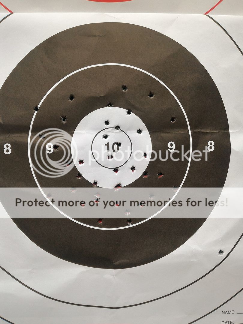

As of today I managed to get around 500rnds (approx.) through the rifle and here are my conclusions.
***DO NOT USE THE BIPOD.***

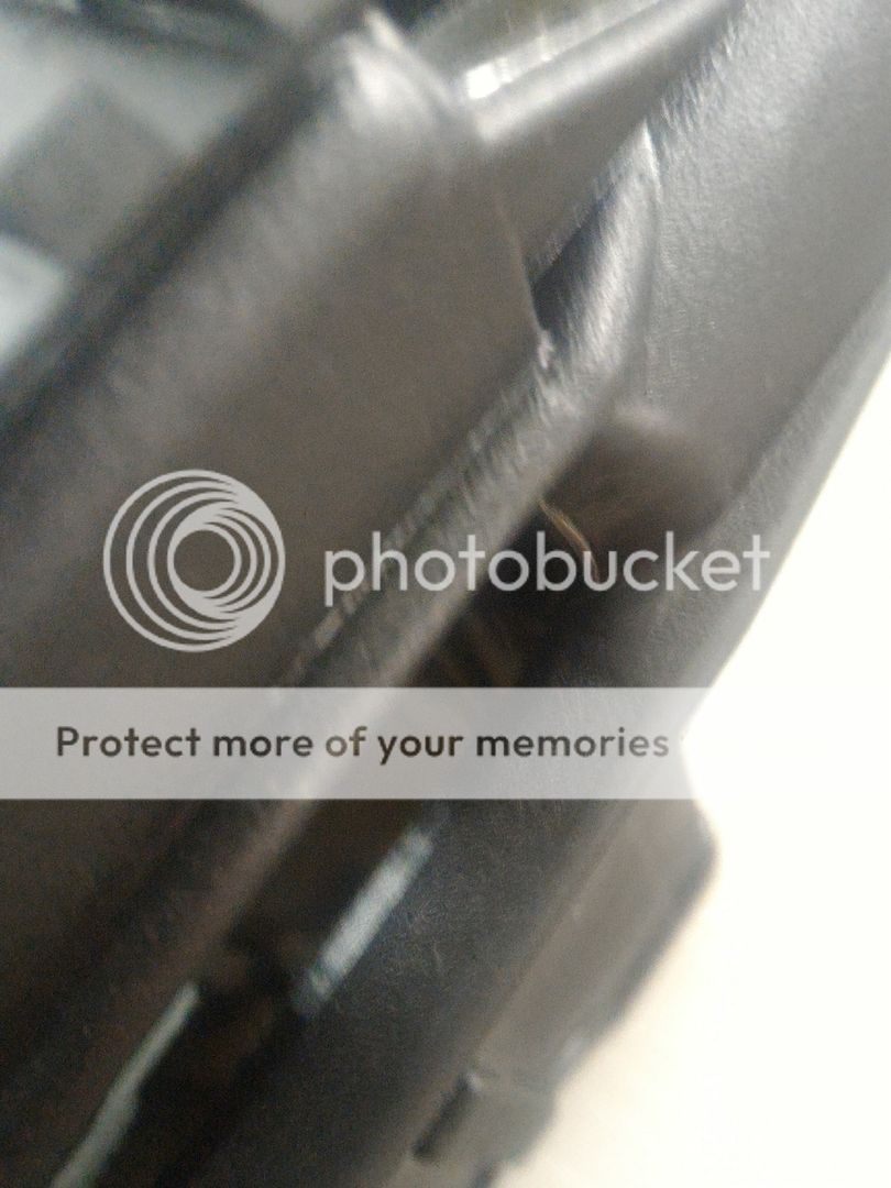

I figure I wasted about 350 rounds before I realized that the goofy bipod fore-end was the cause for my terrible groups and continuous failures to eject. No kidding. I was getting a spent-brass jammed/stabbed in the plastic, forward of the ejection port, making for a nice mess of the beautiful plastic receiver. I tell you, I had a serious case of buyers remorse when I saw my "chewed up receiver from the dozens of cuts that the brass had done after a few hundred rounds.
I then had an "AHA" moment and decided to fold-up the "bi-pod" and shoot off of sandbags as I would any other rifle and wouldn't ya know... no more failure to feed and the accuracy improved from peppering-the-paper, to a respectable 2"-3" MOA at 100m.

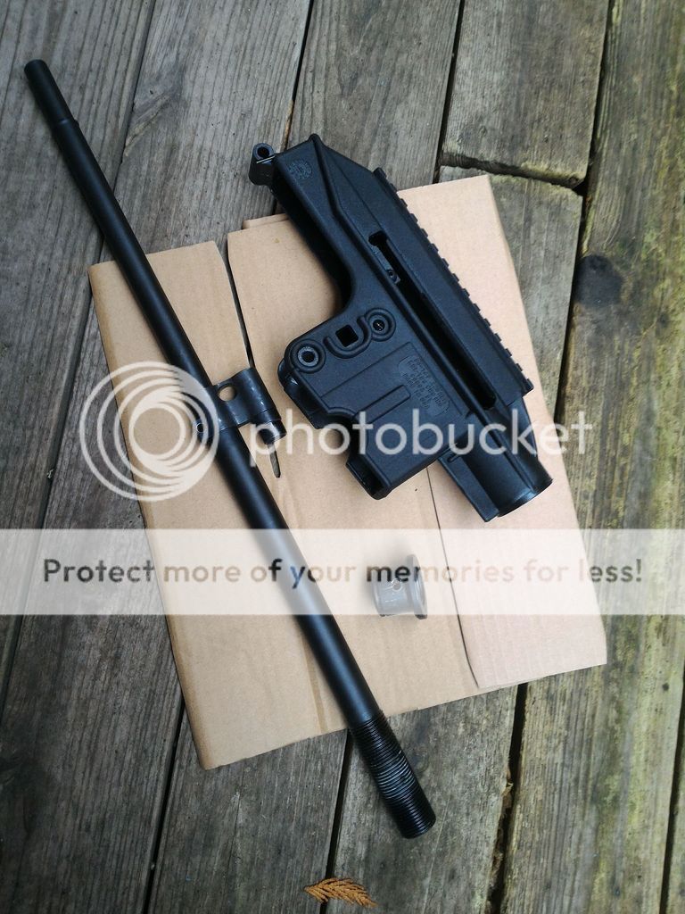

Anyway... after my latest range trip, I decided to remove the barrel (not recommended) and am going to get it threaded for a Flash Hider. I was happy enough with it that I'll plop a little more money down and see if I can't improve upon it a little.
I'll report back again in the future (December/January) once I get more time in with the barrel work done.
