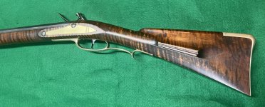

The requisite pic. ;)

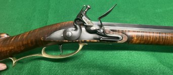

Hi,
I have built and shoot several linkers including the Woodsrunner. Easy to assemble and shoots really well. I used aquafortis but dark brown leather stain works well too. This is my Colonial I recently assembled.
