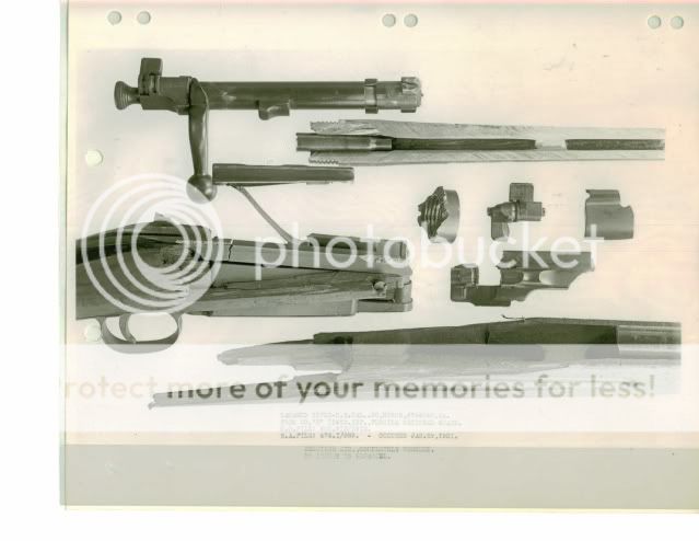

US Krag problems are nothing new.
The U.S. Krags were chambered for the rimmed .30-40 Krag round, also known as ".30 Army." From 1890 to 1893 a 230-grain steel- or cupro-nickel-jacketed bullet was issued, for which no ballistic data is known. From 1894 to September 1899 a 220-grain jacketed bullet loading was issued using 40 grains of nitrocelluose powder, which developed some 40,000 psi and a muzzle velocity of 2,000 feet per second (610 m/s) in the Krag rifle and 1,960 ft/s (600 m/s) in the shorter carbine. In October 1899, after reviewing the experiences of the Spanish–American War, a new loading was developed for the .30 Army in an attempt to match the ballistics of the 7×57mm Mauser cartridge. The new loading increased the Krag rifle's muzzle velocity to 2,200 f/s at 45,000 psi. However, once the new loading was issued, reports of cracked locking lugs on service Krags began to surface. In March 1900 the remaining stocks of this ammunition, some 3.5 million rounds, was returned to the arsenals, broken down, and reloaded back to the original 2,000 ft/s (610 m/s) specification.
http://en.wikipedia.org/wiki/Springfield_Model_1892-99
https://books.google.ca/books?id=tu...EwAA#v=onepage&q=US Krag cracked lugs&f=false
US 1892 model Krags also had only one bearing locking lug and sharply squared off action corners while the Austrian Steyr built later Model 1894 actions had 3 bearing locking lugs and radius action corners as well as better steel formulation!
The incident report says that the unused reloaded rounds were only 2/3rds filled with slow burning powder too! A prime candidate for SEE! Also the mentioned damaged Krag's receiver ring ruptured and the locking lugs and bolt held! so the fault was not with the Krags action lock-up design!

The report attached implies the issue seems to be with guns re-bbl'd after WW2.
Or did I read it wrong?
I've heard about the single lug theory as well. It seems like the K-J is the US version of the Ross MK3...lots of unsubstantiated stories.
P.O. Ackley ground the lug completely off and the handle held the bolt shut with factory equivalent loads.
Unless it's been dycked with ( rebbl'd or tweaked in some mindless way) it'll hold together with a proper loading.
IMO of course. Someone should be along soon to dispute it.
But my Springfield Krag - Jorgenson is still going out deer hunting, it's a marvelous rifle.
The report says they found toolmarks or such, that implies that the rebarreljob was done by someone else than a professional gunsmith. It can not be ruled out that it was a contributing factor. An SEE would probably have blown the rifle up anyway. After ww2, a lot of Krags were rebarreled by guys who just bought a new barrel and installed it themselves. If you see marks from a plumbers wrench around the chamber area, you know it wasn't a proper gunsmith job. My first Krag had a .22 cal barrel, installed by my uncle sometimes in the 70's. Years later I tried to reinstall the original barrel. I could screw it in by hand untill it stopped. With the sights in 11 o'clock position! The barrel was completely loose, so the threads on the .22 cal barrel must have been oversize. I trashed the whole thing and bought another Krag.
