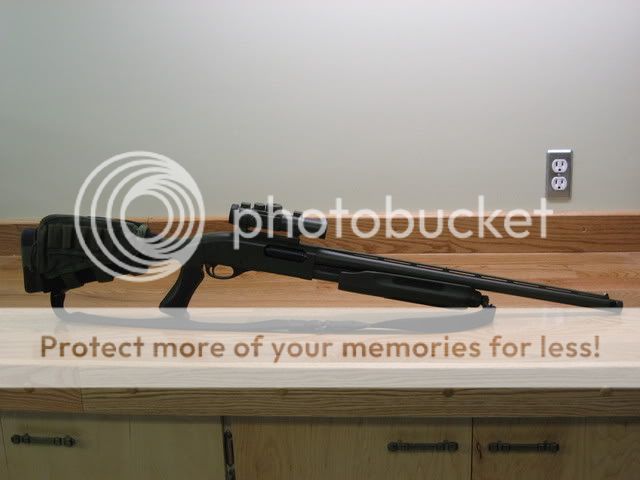

I just recently finished my 870 in Krylon Olive Drab and Flat black. I used a matte clear to finish up. So far, it seems pretty durable, but I am letting it sit (fully cure) for a month or so before I handle it.
I used CLR to strip the blueing and acetone to degrease. Just before the primer coat, I used rubbing alcohol to make sure the metal was clean.
So far so good.
James
Krylon with 2-3 coats of matte clear coat has stood up for 2 years of hunting and still looks new. Give the clear coat 2 weeks or more to cure.
