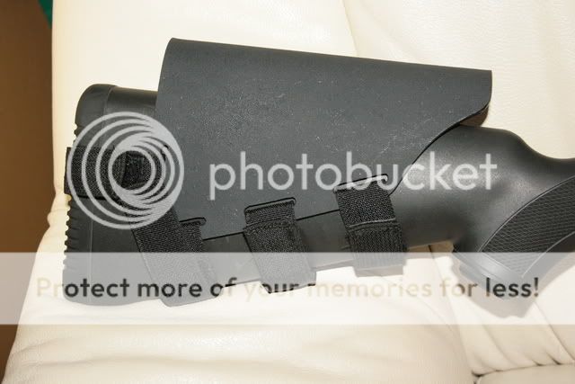

So after a reading through a thread on cheek rest idea's I decided to expand on my older lace up kydex cheek rest. There were suggestions on using the Blackhawk system, but I did not feel like sewing one together. So I took the mounting system from that rig and adapted it to kydex with a some input from a member here this is how it came together. Height is adjustable with layers of dense foam, and I kept it from sliding with the compression of the straps and a some non slip material. Can't wait to test it out, let me know what you think.....
Thanks for all your input, here is the second coming of my cheek rest. Velcro securing straps, rear butt strap.

Looks good but I am wondering if the ends of the straps tickle your neck? I t would me a bit of a distraction when trying to line up a shot if they did.
I am also wondering the same as maple leaf eh
Thanks for the feed back. Straps were left extra long for the intended users rifle, I'm not sure how much they will need (this is the first one I made).

IMHO, lose the buckles you currently have and make up some velcro straps like the Eagle has.This will allow you to have the straps tighter , easier to adjust, and they won't loosen off.
Also look at putting a rear strap ala' Eagle in order to keep the rest from sliding forward.

SKBY, Sounds like a plan.....will post versions of Ver. 2.0
