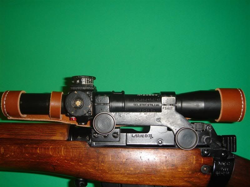

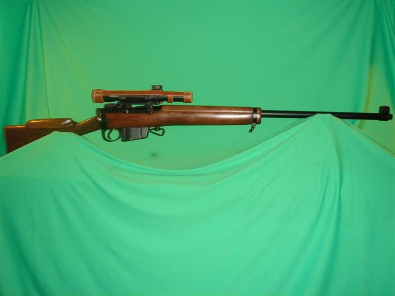

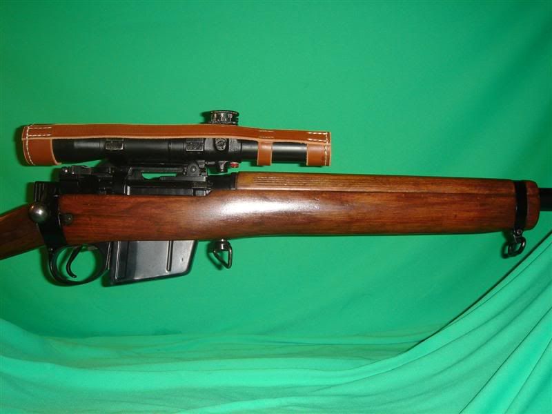

Here you go....
The rifle belongs to ~Angel~, not me, but I at least get to handle it to take pics ... :D
1971 Enfield L42A1 Sniper Rifle
(Click Pic To Enlarge)(Click Pic To Enlarge)
1971 Enfield L42A1 Sniper Rifle (lots more pics ... click here)
Hope this helps....
Regards,
Badger
Those are excellent pics, Badger: that is an awesome looking rifle. I'm going to set up something similar to what ~Angel~ has there. Call me what you will, but I don't see anything bubba in setting up a configuration like that. Looks good and probably shoots good too.
