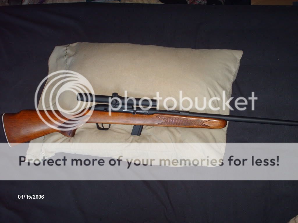

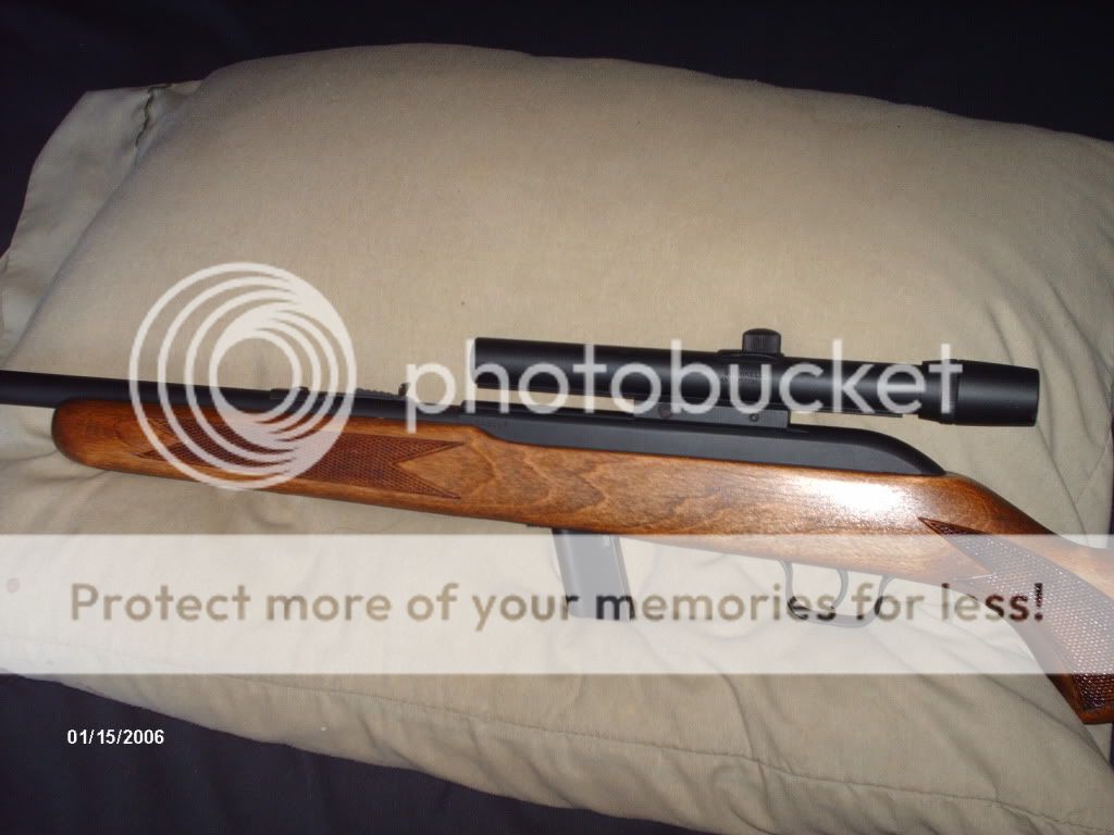

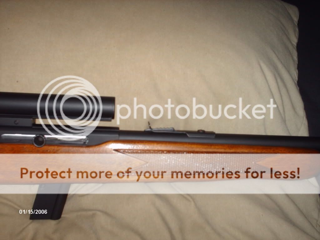

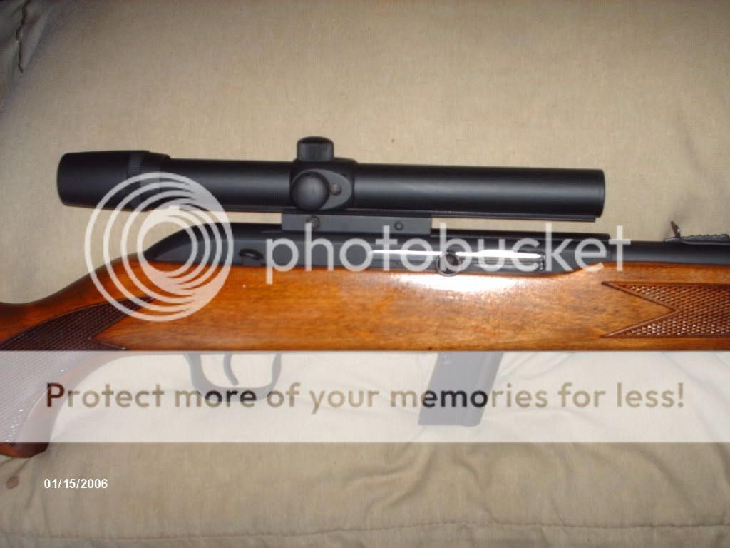

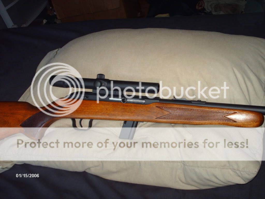

Anyhow here are the pics of my finished job, total of 4.5 hours work involved including metal and wood re-finishing, recessing and lapping the crown and polishing of the bolt, inner action and trigger group. i really wish i'd taken a before pic because it was bad, 50% finish gone on the wood and the metal was totally rusted and pitted... fortunately the bore was caked in lead and cleaned up with a mirror like shine. off to the range tomorrow to sight in.
And yes my cameras date is off... i'll put up a penny pic if there's any doubters it's mine.
