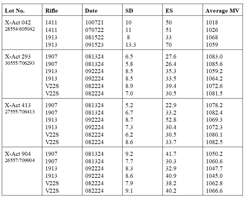

This season I wanted to test all the Lapua X-Act I could get my hands on. I bought ammo from three different lots of X-Act, which were not the same as the first. I had tested a few boxes of the first lot of X-Act with two rifles. The recently acquired three lots were tested with three rifles.
Below is the chrony data accumulated for four lots of Lapua X-Act. It should be noted that the chrony results for the 1411 have slower MVs than the other rifles. Although the barrel is the same length as that of the 1913, the 1411 has a slow bore. I haven't included the temperature differences between days and boxes, but suffice it to say that warmer temps typically result in slightly faster MVs.
What's potentially important are the SD and ES figures. Ideally with good match ammo SDs are usually in the 5 to low 7's range, with ES figures in the 20's or very low 30's. Of course, chrony numbers don't determine or dictate how an ammo will shoot.

It is for a number of reasons. None of the four lots can be described as having consistently good chrony numbers. (More on shooting performance later.)
One reason that springs to mind is the question of how these lots of Lapua could be labelled as X-Act, the top tier Lapua match ammo.
With wide ES and high SD values, why didn't factory testing identify at least some of these lots as being something other than good, top tier ammo? It makes me wonder about how match ammo is graded.
Another interesting thing is about the ammo we get in Canada. I'm thinking that on average Lapua X-Act is very good ammo. Why are the lots of X-Act that are available to Canadian shooters such poor examples? What are the odds that the four lots available in this country are all not especially good?

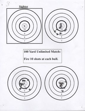

Below are the 1907 results from August 13, 2024. It should be noted that some groups were affected by wind.
In each lot, however, other groups had outliers or flyers not due to wind, which is to say errant shots went either high or low. Except to say they occur with these lots, those kind of shots are otherwise unpredictable.
Generally speaking the results with the X-Act lots are more inconsistent than those with the Midas lots tested this season.
The three lots of X-Act are shown below, beginning with lot number ending 904.
Below are the 1907 results with X-Act lot ending 413.
Finally, below are the 1907 results with X-Act lot ending 293. Wind aside, this lot may have the best results of the day.

The X-Act performance on target is inconsistent and poor. Group sizes with some lots vary by as much as two times.
The bottom line here, literally and figuratively, is that the X-Act lots available are not especially consistent, either on target or over the chronograph.
