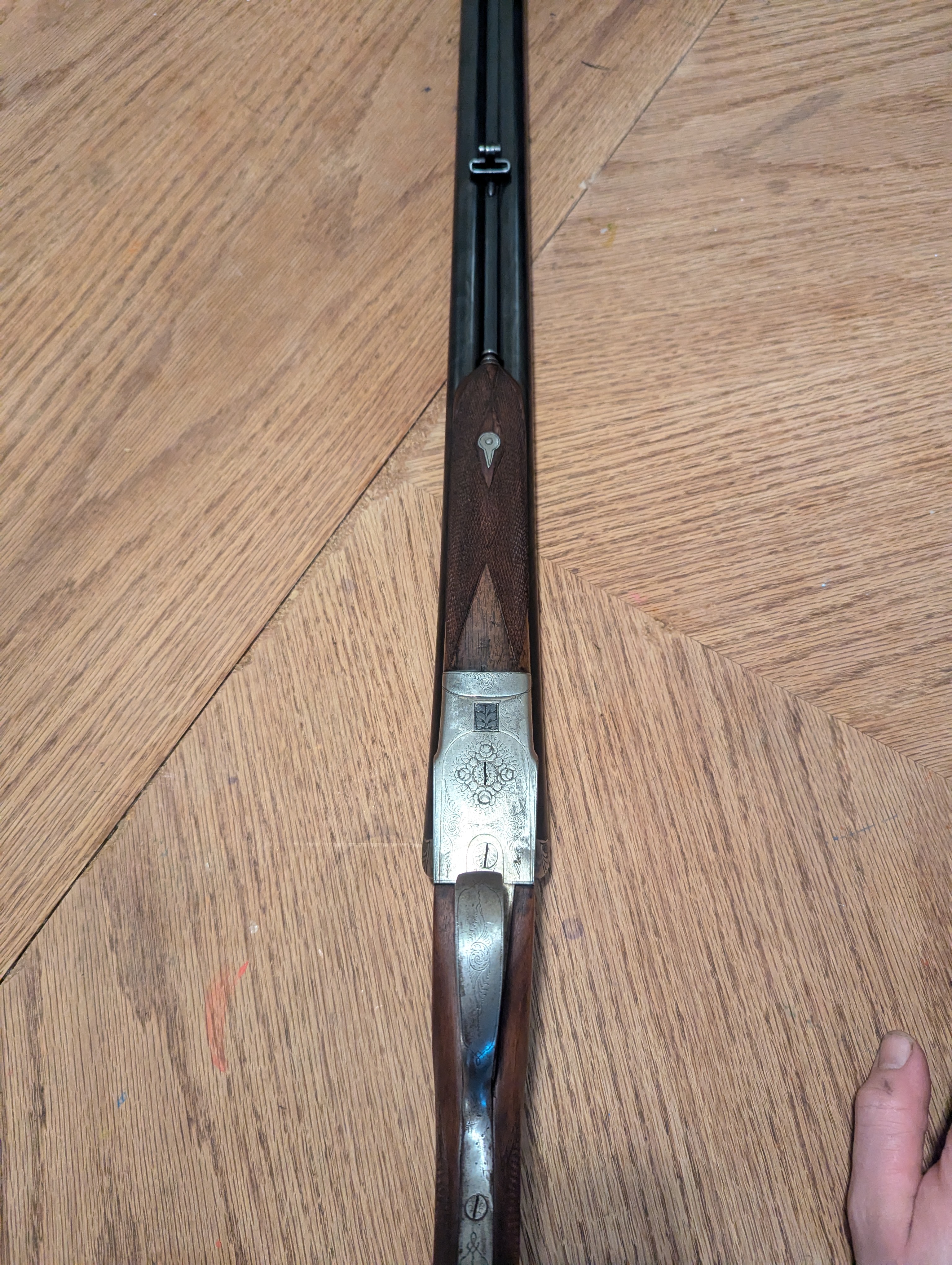

good news, i got my shotgun. bad news, its the wrong one.

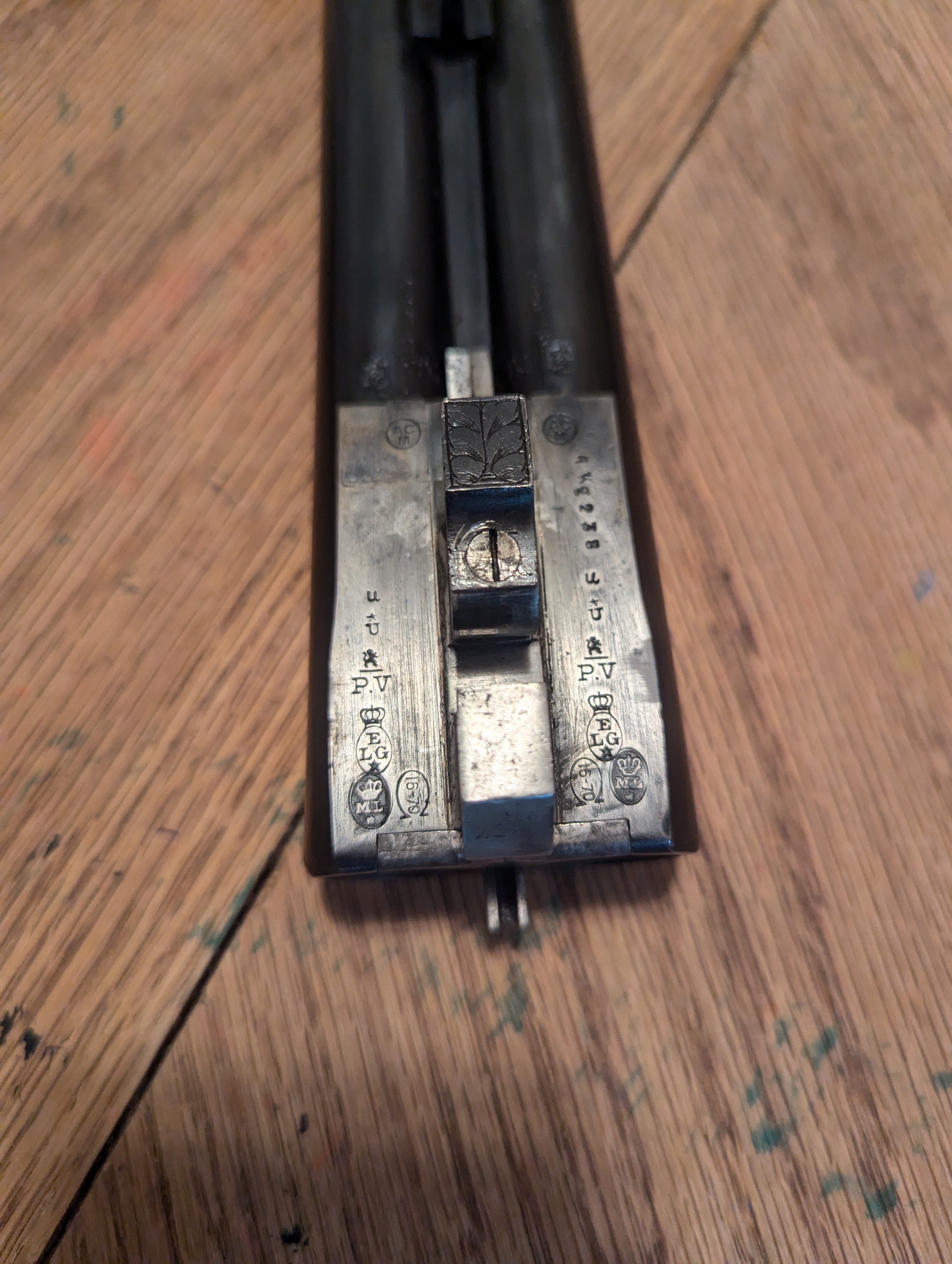

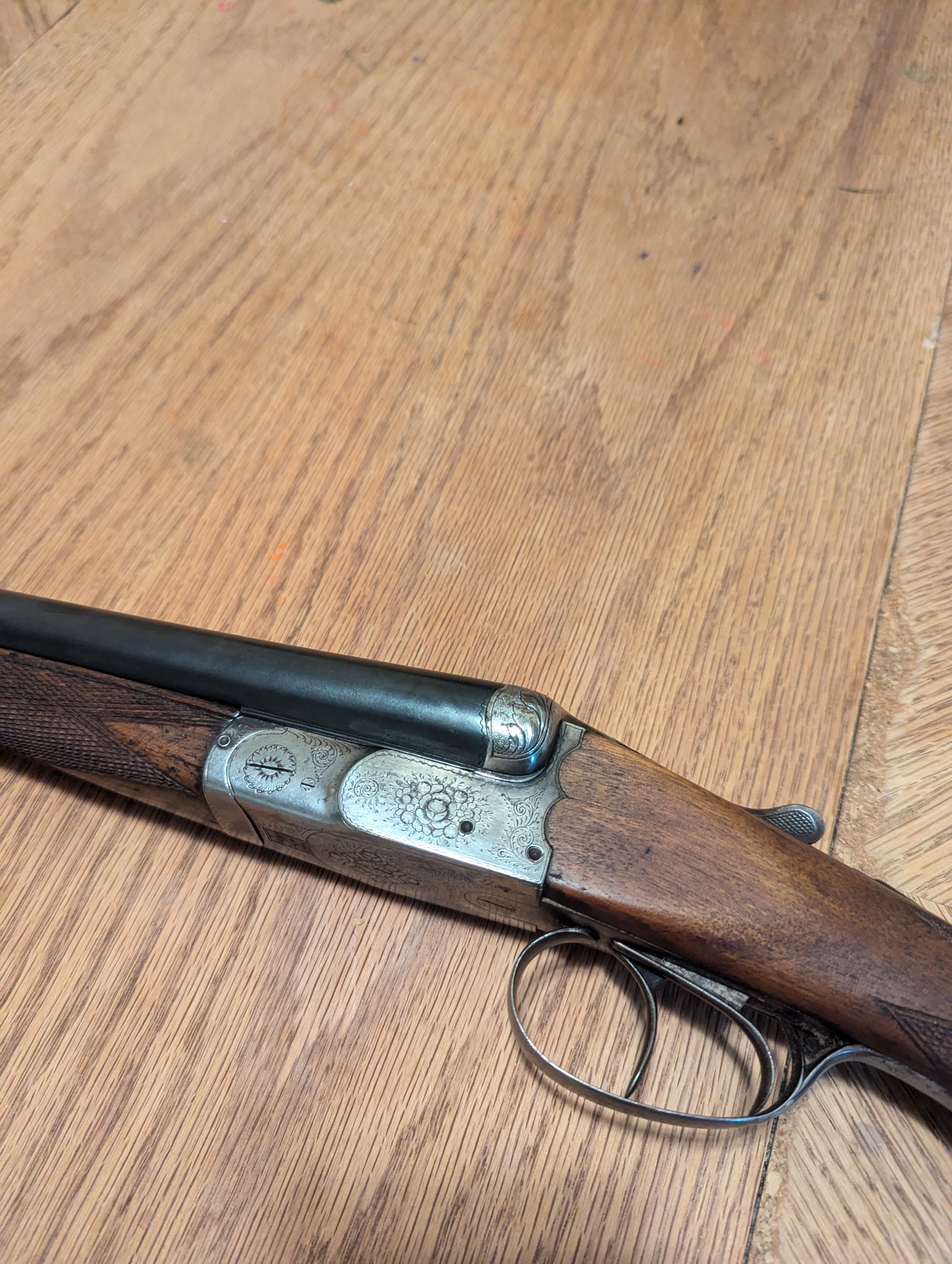

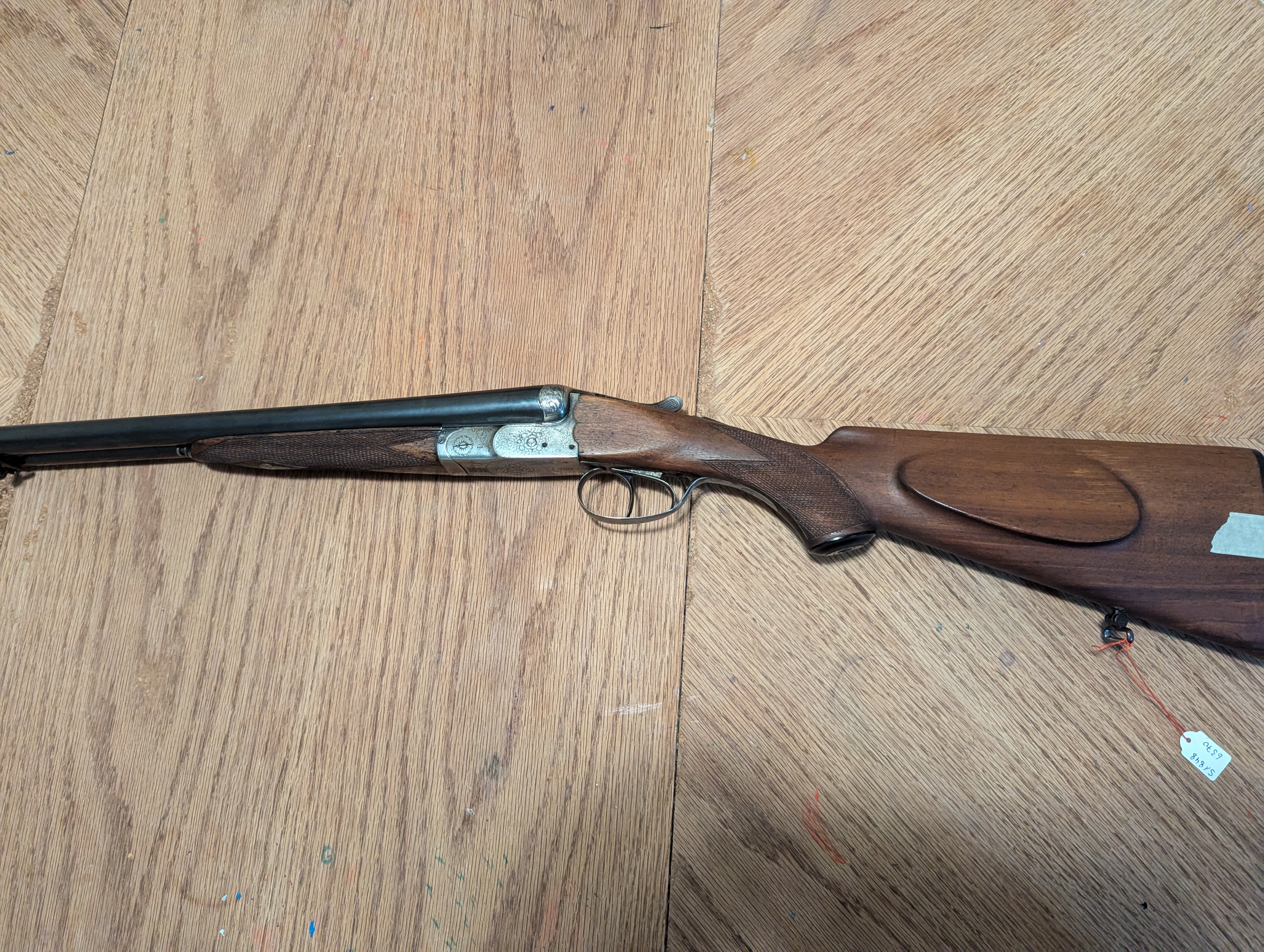

this shotgun seems to be a Belgium 16g top lever with a 3rd hidden lock.
the gun is really nice. it has side clips on the chambers, 3 locking points, ejectors opposed to extractors, light weight (6 pounds even), feels and points really well. feels like fits me awesome. the only other feature it could have but doesnt is cocking indicators.
i really like it, so I'm going to see what the seller has to say, i want the under lever hammer gun really bad for the 577 snider.
this rifle seems like it should be chambered in something that isn't black powder (at 6 pounds it could be anything from 22 hornet to 45-70 (i already have a double rifle in 45-70 so t wont be that)), so if the seller doesnt offer anything but an exchange ill probably keep the gun, if they want to cover all shipping or give me $100 off the under lever ill keep/buy them both.

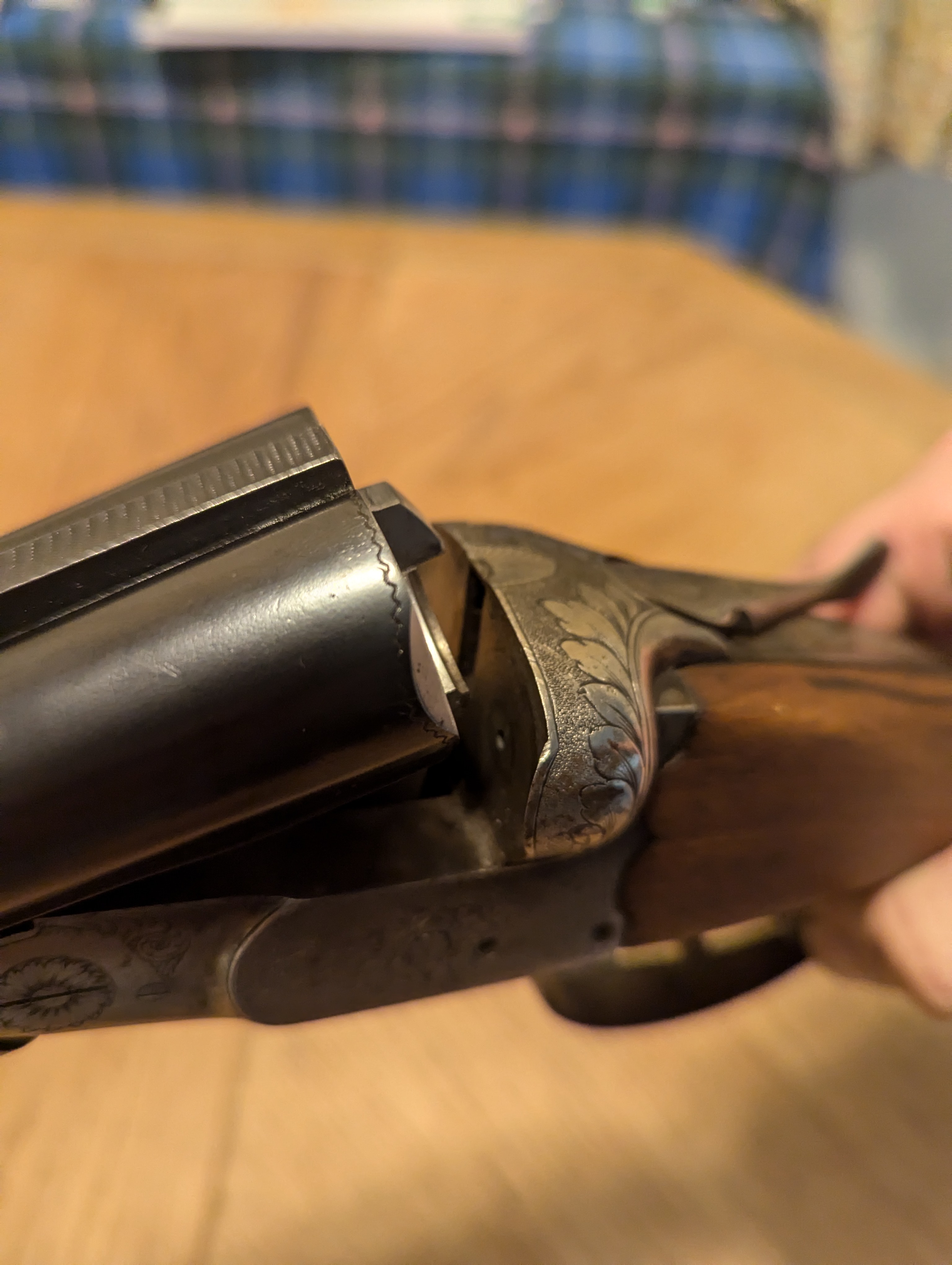

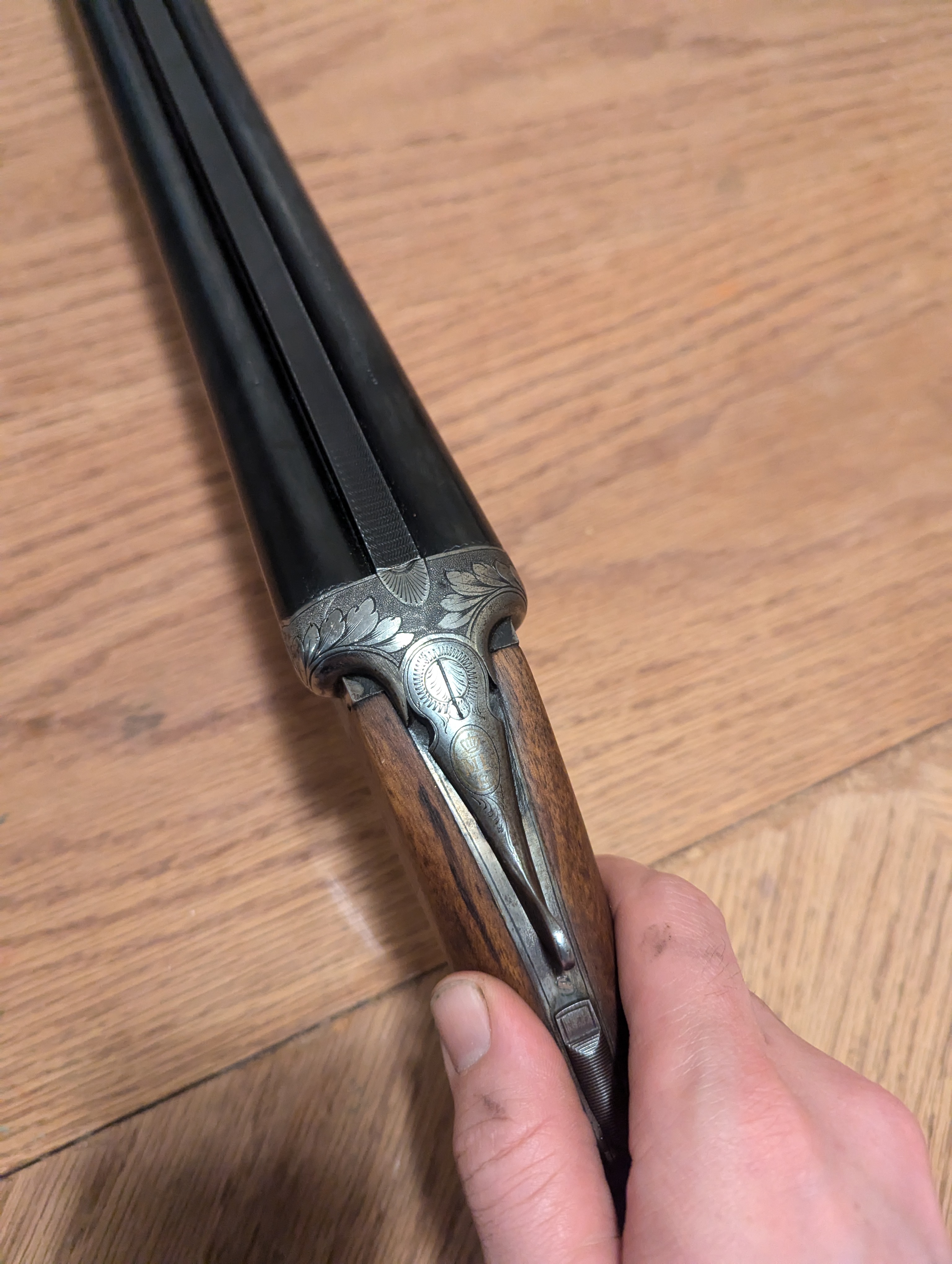

this gun feels so slender and small compared to my Suhl 12 gauge, i do love the feel of it, very fine feeling gun, as seen in pic 3
That's a really nice gun
Honestly have always thought those east german guns would make nice rifles
The stocks are cut for shooting hares on the ground, have cheek pieces etc already.
Hurry up and practice so you can make one in 12 gauge for me lol

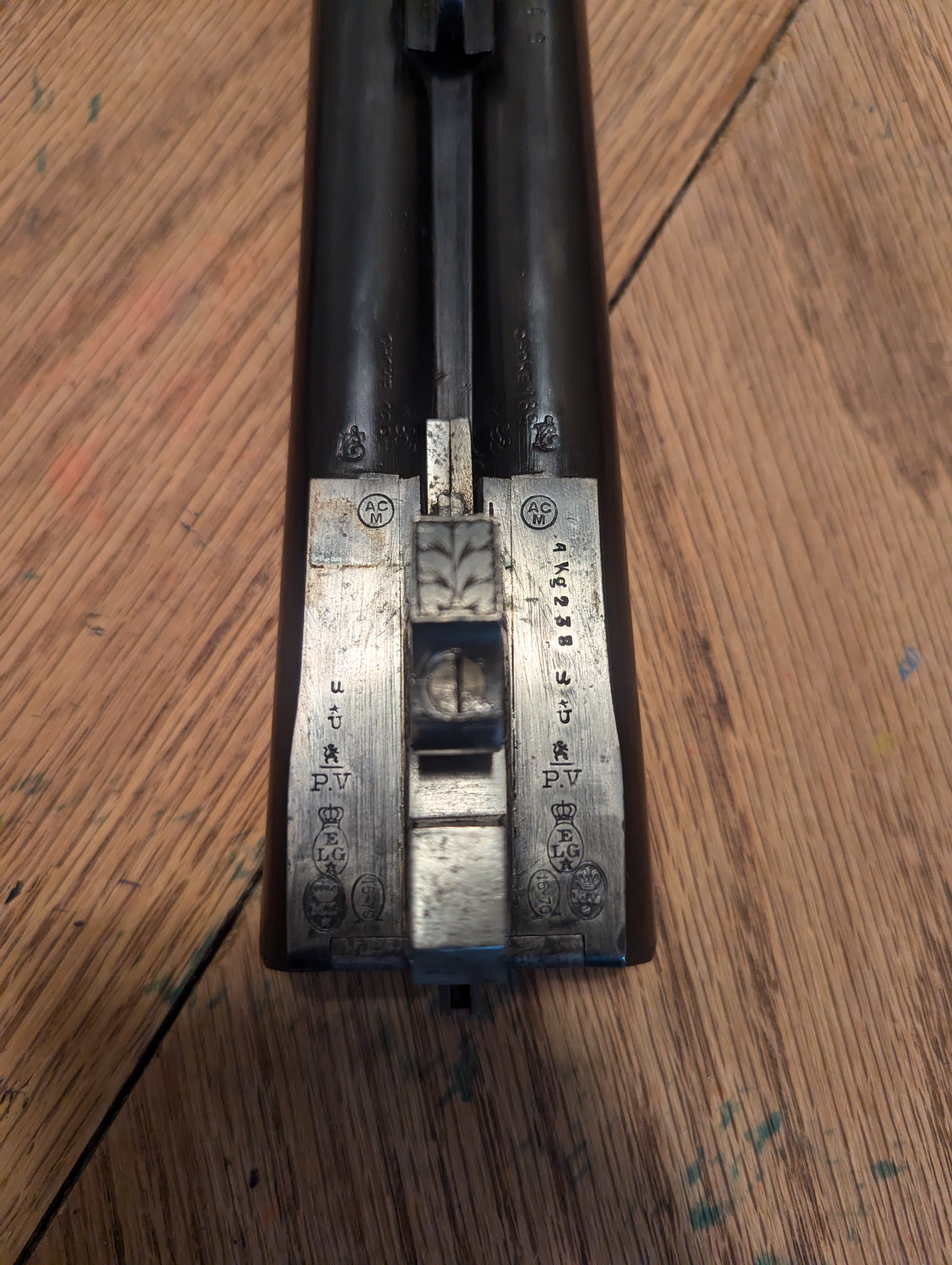

Evan, why do you think made in Suhl and not Belgium?
Although I did say that, I don't really think it anymore. It was before I looked at the proofs, I was looking through intersurplus website finding more of these same shotguns. They had these shotguns listed as simpson shul. But after looking at the proofs I can see it's not Suhl and it's Belgium.

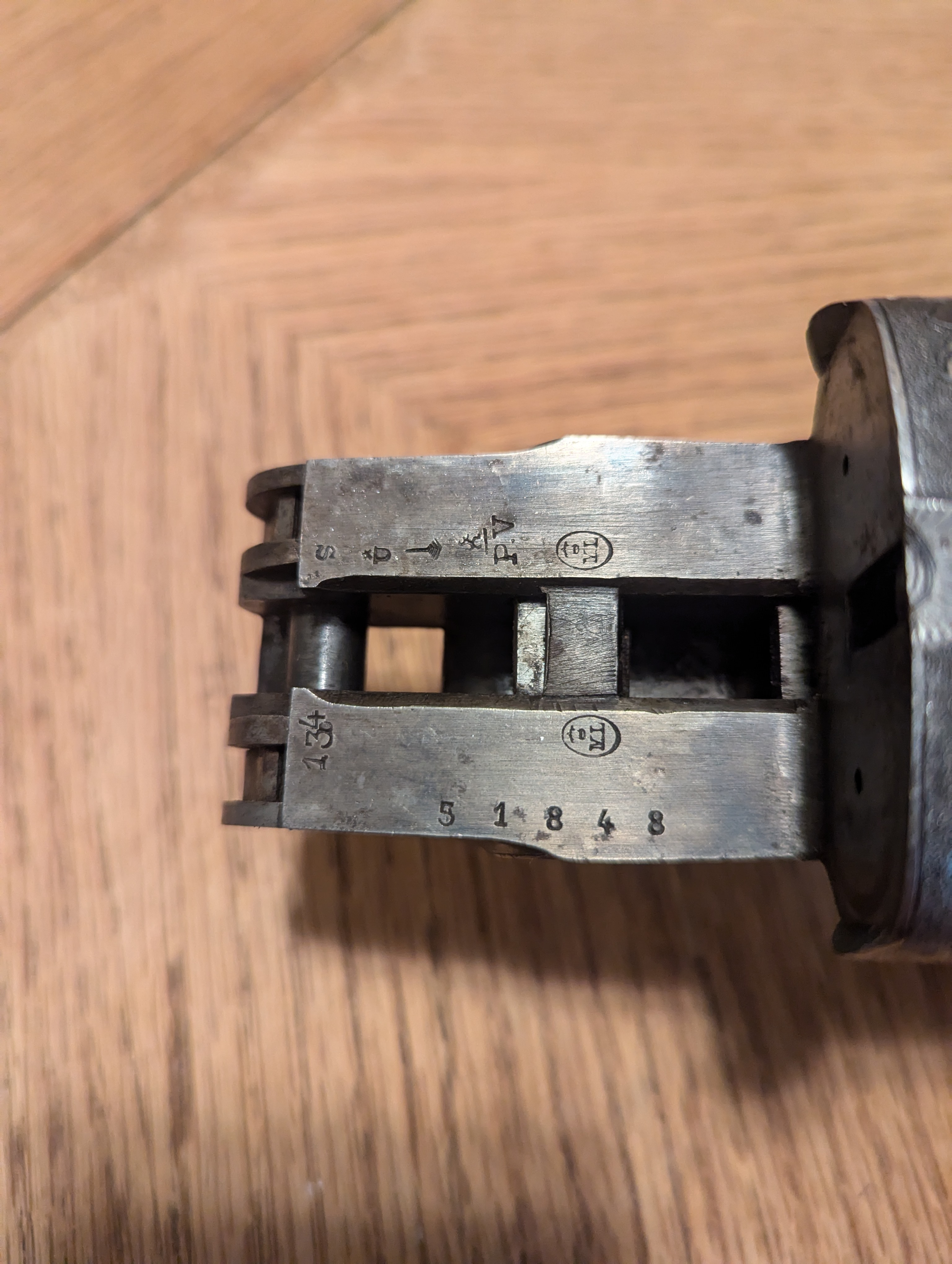

Ok so I have some good, neutral, and bad news about this build.
The good news is I bought the gun that was shipped to me(pics in previous post), in addition to the under lever hammer gun I originally bought.the unexpected shotgun has side clips, 3 locking points, double bite and hidden cross bolt, made for smokeless and selective ejectors.

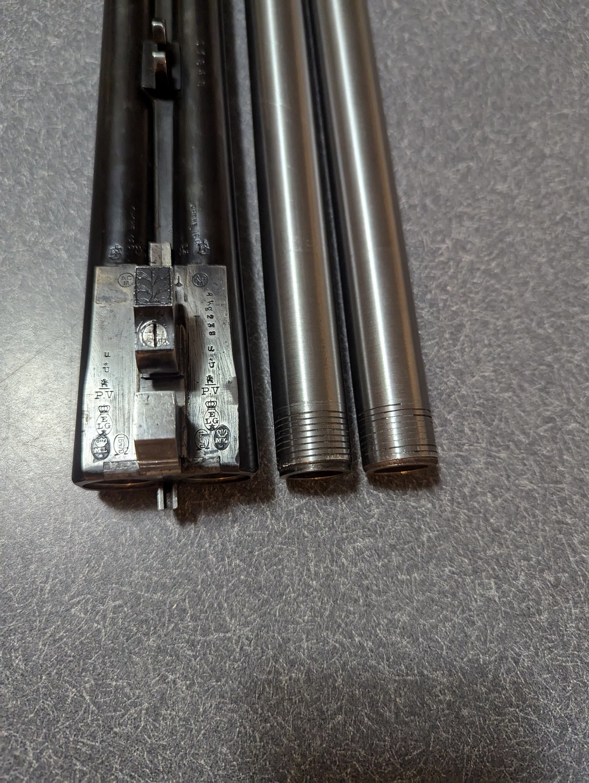

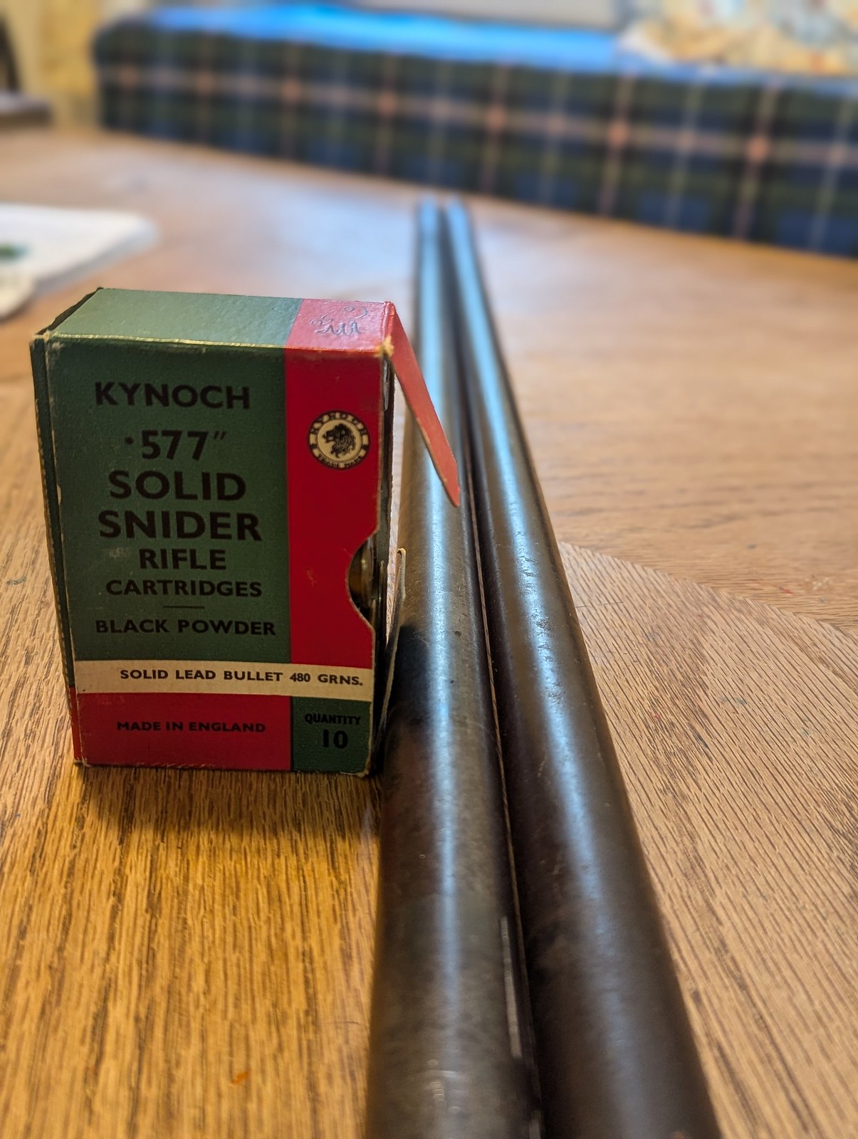

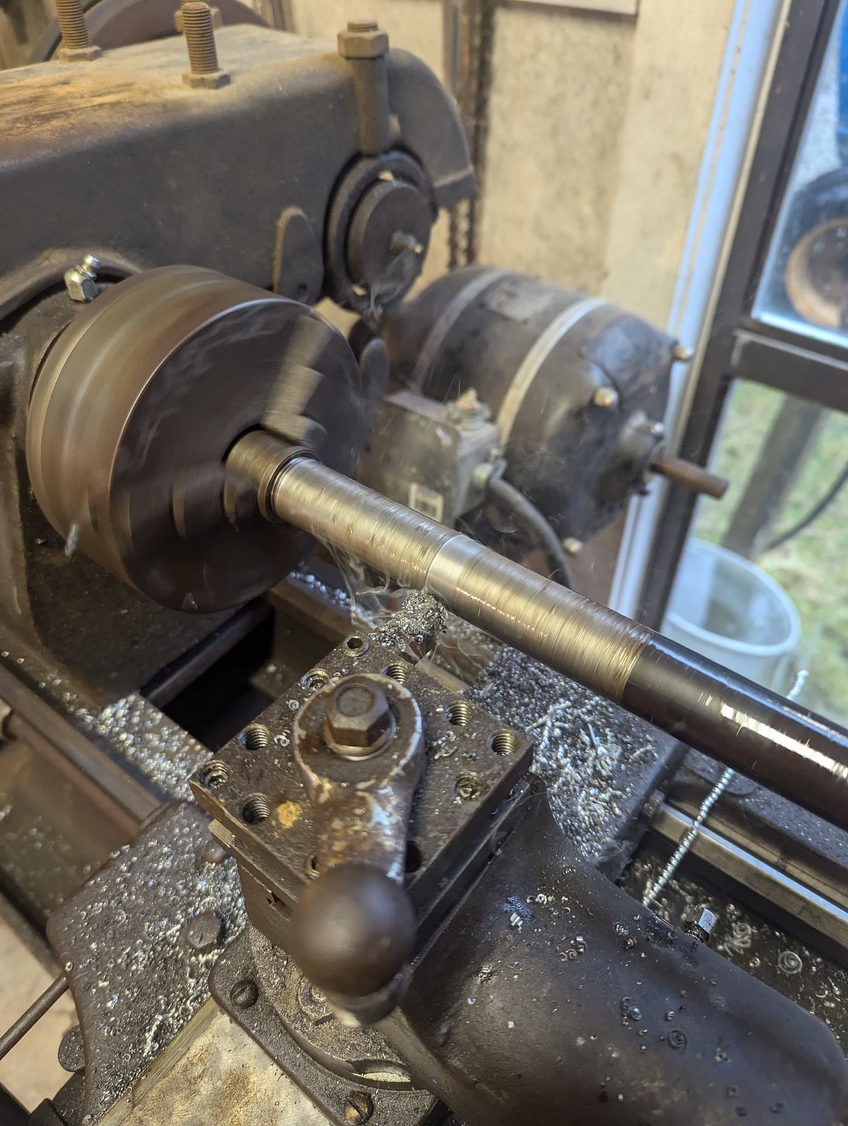

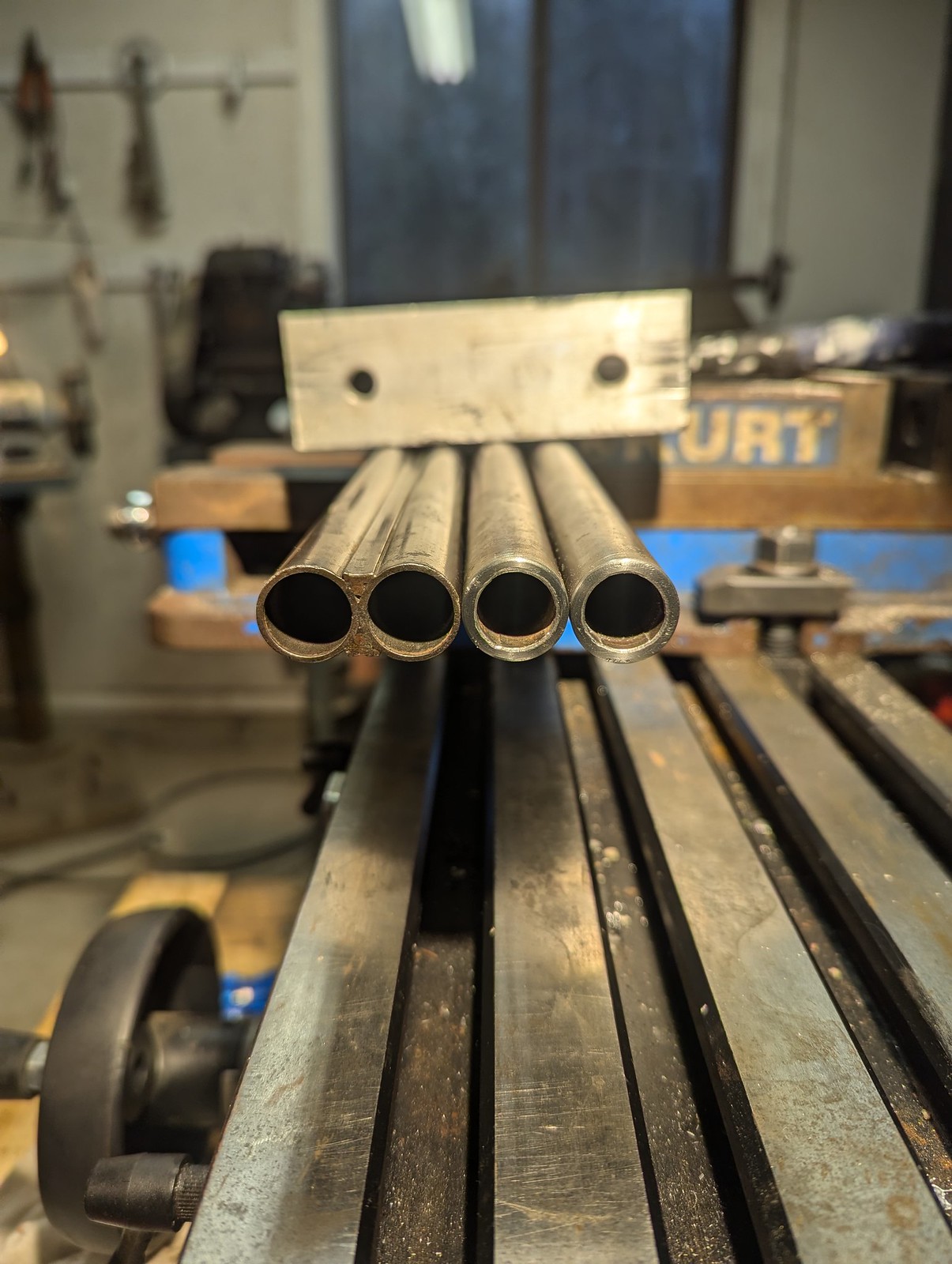

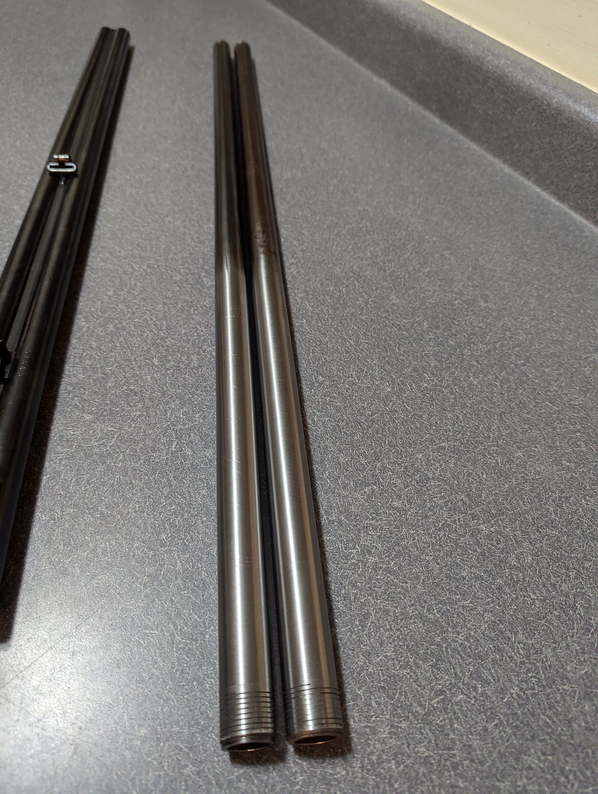

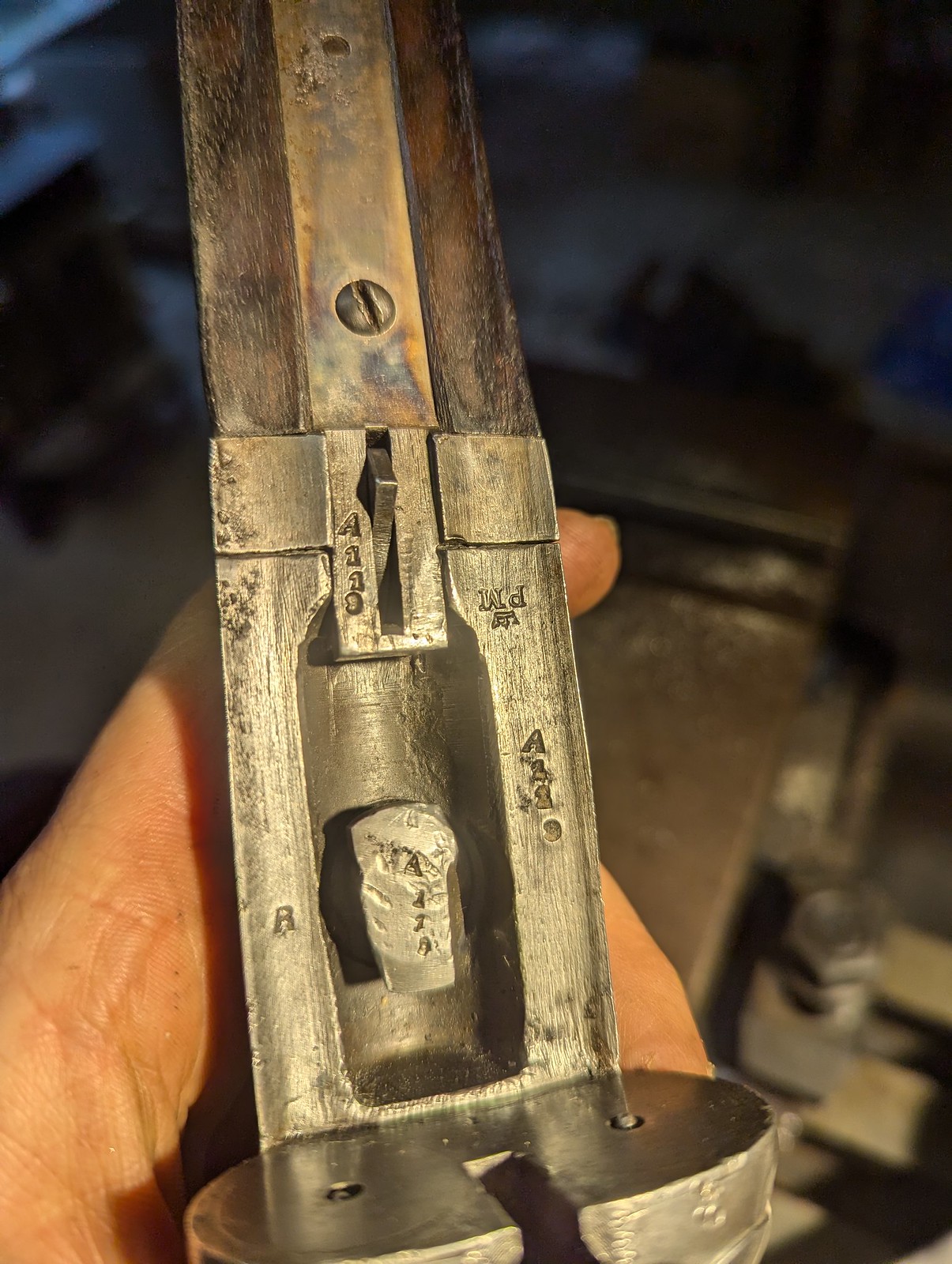

The neutral news is I got the 577 barrels turned and shortened for use in a 16 gauge shotgun. They are now 28" long and from the point they are 23.5mm diameter to the chamber the are turned straight. The 16 gauge shotgun barrels are 23.5mm diameter at the end of the water table. I removed 0.118" from the wides point on the 577 barrels. They were 26.5mm at the widest point before their threads.

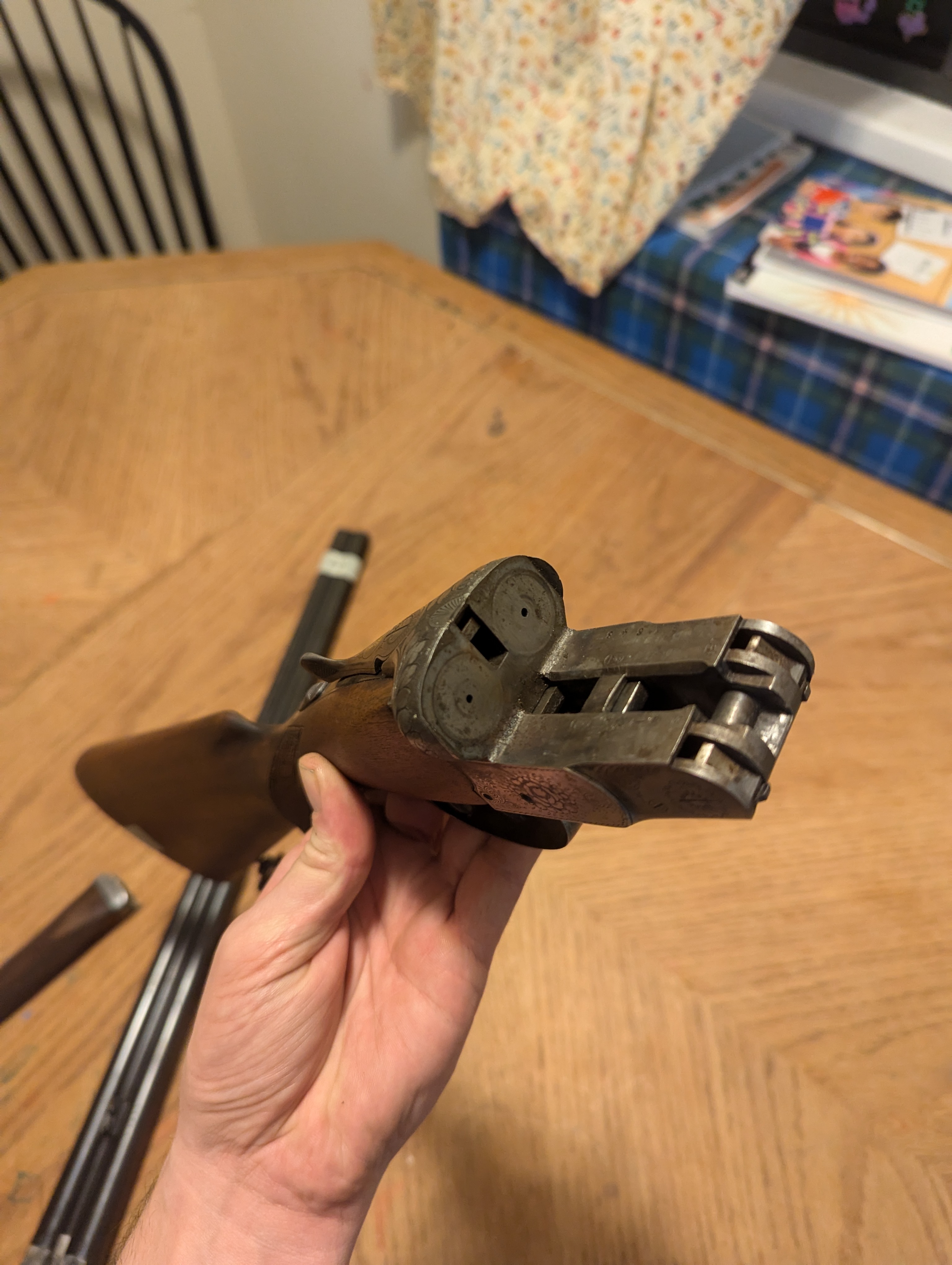

The bad news is the under lever I bought for this project isn't going to workout. I'm glad to have it as it's a awesome handling, light weight, fast/easy pointing gun but better to use it for a smaller diameter case/bullet built. It's not nitro proofed and has very fine barrels, no real water table, and doesn't have the material to use the 577 barrels in it as a mono block.
The underlever is on the back burner as another project (I'm interested in doing a 25-25 Stevens build or something old and odd, maybe 43 mauser) but the unexpected shotgun sent to me will be used for the 577 build. And I have pics to add but they need to be a different post. I need to use my phone to post it and flicker isn't so phone friendly, so it's a separate post.
The first 2 pics are the barrels and action of the underlever. Showing no real water table and very fine(thin) barrels
The other 4 pics are the 577 barrels being machined and the muzzle size compared to the 16 gauge and the barrels next to the barrel set from the 16g ill use as a mono block
I plan to thread the barrels in the mono block using 13/16-20 threads for 25mm at the chamber end, then boring the rest of the mono block to 23.5 mm. After threading and setting headspace I'll solder the barrels into place making it one unit.
