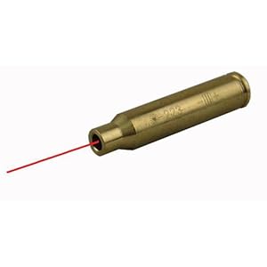

Is there anyone who manufactures a laser site that goes in the barrel and you look downrange and adjust/site in your scope? I recall reading something like this but can't rememer where I read it ... does somebody make something like this? Thanks for any help.

Are you talking about just a cartridge boresighter ?
You will find pretty quickly that they are a waste of time and money. The laser is generally too weak to see during the day and by the time you finish screwing around with it you could have just set up a big target at 25m and sighted in your scope.
They are especially worthless for bolt guns where you can just take out the bolt and look down the barrel at the target.
Of course, if you really really want one, don't let me influence you.
My buddy is sending his back now. When the bolt does turn it on its very weak. When we found the dot it was more then 12" off after the gun was sighted in. His was the 223 in a 270 sleeve from cabalas
I've been using one with my .338WM for 6-7 years. It does save ammo but I would never go out hunting without shooting the rifle at the range first. Usually, I need to adjust the scope a few clicks. I would not recommend buying one for rifles that shoot cheaper ammo.
They work okay as boresighters to get you close to the centre of paper when sighting in a new scope, about as well as sighting down the barrel of a bolt gun. For levers or others that aren't easy to boresight the old-fashioned way, they aren't bad.
If, like me, you play "musical scopes" a lot, switching scopes back and forth between guns in search of the mythical perfect match, they are great. You look through the scope (previously sighted in), note where the laser appears on the the crosshairs, remove the scope and mount the new one without touching the laser, and then adjust the new scope until the laser dot appears in exactly the same position. In order for this to work, you must insure that both scopes are set to the same magnification, and are at the same height above the bore. You must also use the same target at the same distance (25 yards works well) for both scopes. By doing this you can literally sight the new scope in absolutely perfectly...I've done it many times.
If you are changing scope mounting heights, i.e. higher or lower rings, then this still works if you do it at night, so that you can see the laser dot through the scope at your sight-in distance, 100 or even 200 yards. It is easy to sight your replacement scope in to within 1moa using this technique.
Once again, this is strictly for replacing one already-sighted-in scope with another, and results in the second scope being sighted exactly as the original one was.
Actually, most people don't ever consider that these little contraptions are actually much more useful AFTER you have sighted in your rifle.
They weight about the same as a loaded cartridge, and use the same space. Yes, some are anemic in the light they give off, but some are OK. Buyer beware.
But consider this usage. You go to the range, sight in your rifle, work up the load, etc. etc. etc. Now... Last thing you do is mark the end of the laser sight so you know what side is "up" (or "down) when you chamber it. Chamber it. Look through the already sighted-in scope. If you can adjust the zero on the laser sight, do so. If not, just write down where that laser dot is in relation to your zero. Say, 3" high and 2" left.
Now, when you go hunting, and that nicely sighted-in rifle is bashed about in the back of the Cessna or on the ATV, or if you drop the rifle onto some rocks, all you need to do is find a rock 100 yards away, and pop in the laser sight. Boom, you should be able to confirm your scope is still zeroed. All for the size and weight of a single cartridge.
May not mean much on a day hunt in the back 40, but if you are flying in to a remote campsite...it could save your bacon.
