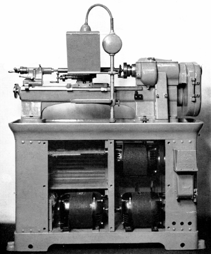

That cromwell is very interesting, the tinkering fun on that would be something else. Its definately in the Hardinge class of very precise tool room lathes, it was a top shelf machine in its day.
The OEM electronics look to be a nightmare though http:// www .lathes.co.uk/cromwell/index.html
Motor turns a generator which in turn drives another motor for variable speed, if a man gutted it and put in a variable speed DC he'd bypass all that trouble that they had deal with in the dark ages. But he'd loose alot of the charm this machine has.
Wish that machine was closer to me Id buy her for sure and try to keep it as original as possible. Its alot of old technology packed into a machine that doesn't have any more capacity then my little myford, but it's georgous.
