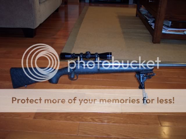

I wanted to see how accurate of a gun I could build so I tried.
Here are the results.
Custom action Shilen BBl and with only scope I had sitting around.....
My first groups with the rifle. That one on the right has 5 shots in it at 107 yards.
WORTH IT??
YES!!
RoA, you're now the official Poster Child for home made rifles. That's mighty fine looking results! ! ! !
