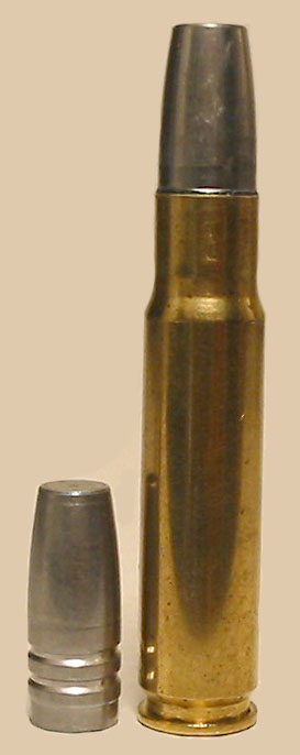

  3. bullet design. Spitzer bullets, sadly, just don't seem to do that well. There's assorted theories on this, but the bottom line is the accuracy boys and the mould makers who cater to them like Eagan (who just passed away this spring) use very blunt nosed bullets with long bearing surfaces.
This is a bullet I designed for cast bullet competition; it worked so well that I scaled it up to .35. It is pretty typical of competition type designs, and that big flat meplat also makes this kind of design pretty good for hunting as well.
Other than all the above, it seems that the bigger the caliber of the bullet, the easier it is to get acceptable results.
