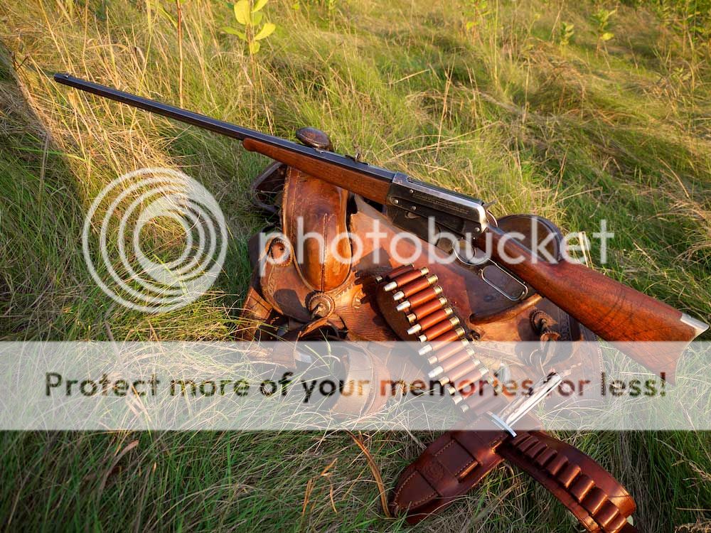

As some of you may recall, about a month and a half ago I had the good fortune of finally acquiring an original Winchester Model 1895 38-72 with a rapid taper octagon barrel, after many years of wanting one and having given up hope of ever getting one. This particular one was made in 1904 and shipped in 1905. It is still in very nice shape. Here’s a photo .....
