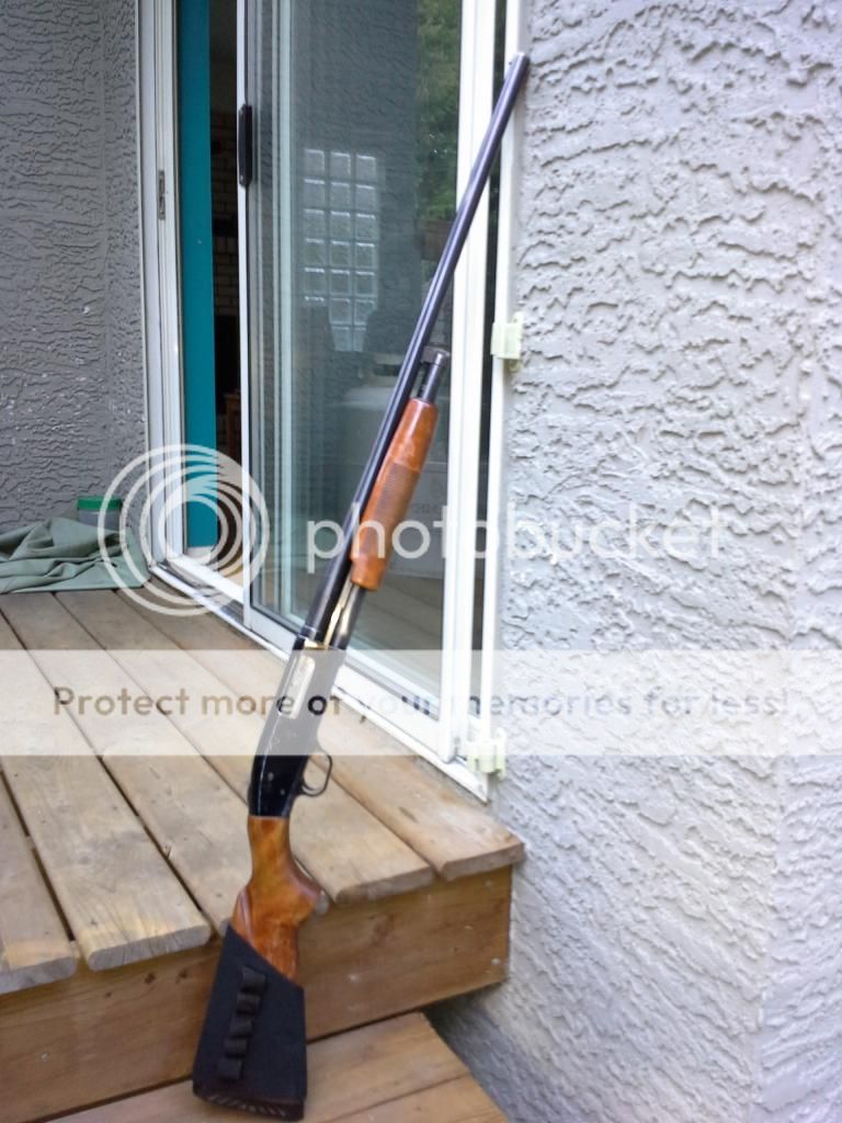

Here it is before I ripped into this project on the weekend:

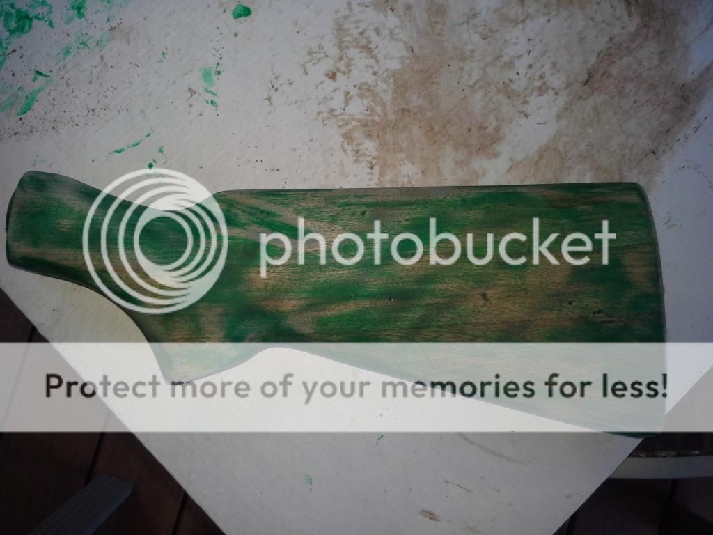

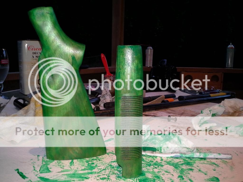

After stripping the old varnish off and a lot of sanding, I then added the first layer of colour - and it was a lot brighter than I wanted it to be, but was hopeful it would darken with oils added on top.

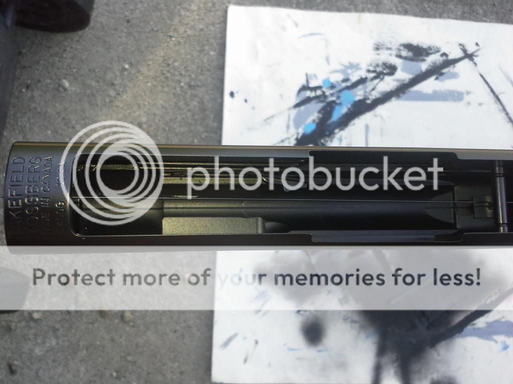

So far, so good. Been chipping away at this slowly but surely. Painted the receiver, ejector, screws, and mag tube the other day.
Today I blued the barrel - that was a fun process and it turned out great. I just used Outers bluing from Canadian Tire and took my time, did several coats and I'm quite satisfied with how well it turned out. No pics yet, I'm letting it cure for a few days.

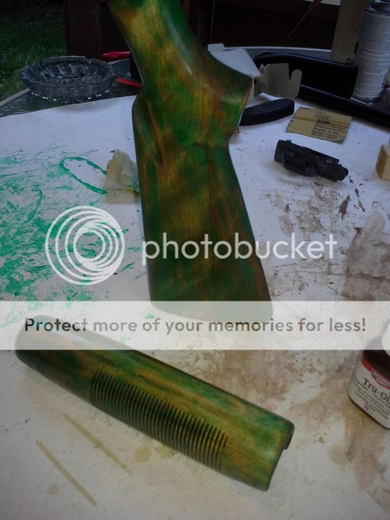

Also managed to polish the trigger assembly, wax the buttstock, and then I sanded down the stock and pump. The natural wood is very light so I wasn't sure if I should stain it to darken it before adding Tru-oil.

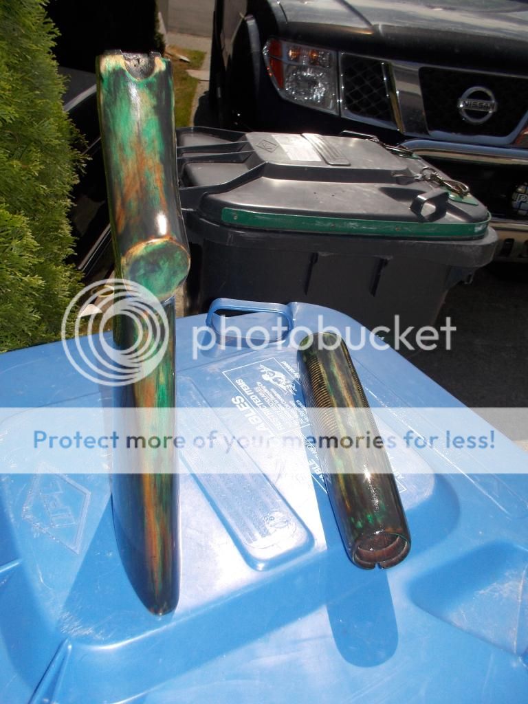

So I wanted to see if the Tru-oil would darken it up, and added a first coat and let it dry. It didn't darken much at all.

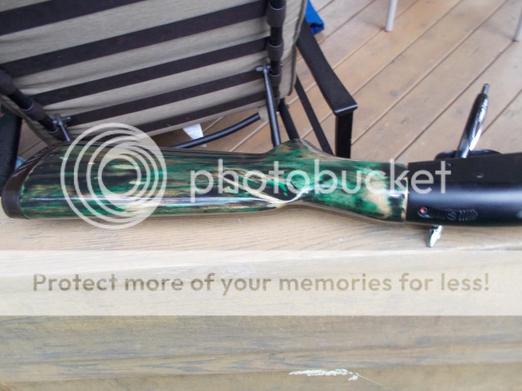

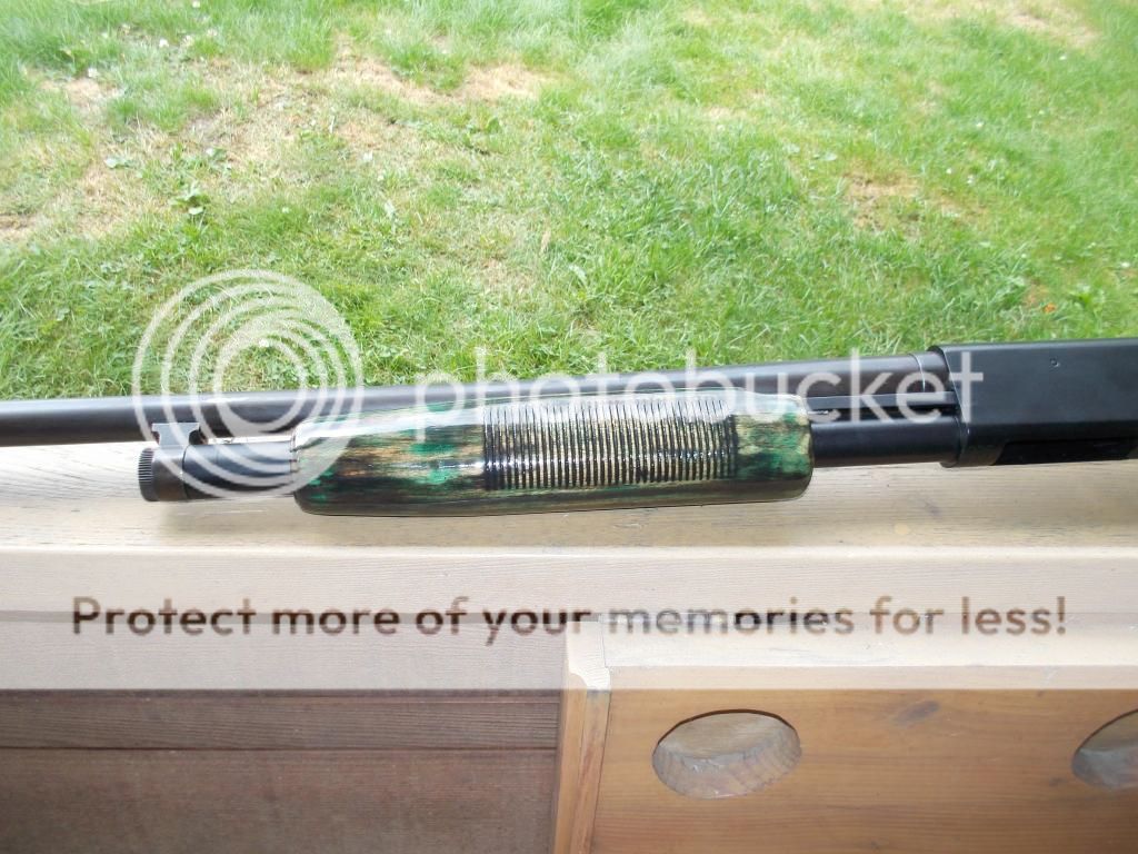

So when that was dry enough to sand, I added a thin layer of black stain and it is now going the direction I envisioned.
I'm going to sand out the grooves in the black stain, I'll probably need to do a second or third coat of black before I can then start back with the Tru-oil. Overall, it's been a great project to do during this nice little heat wave - I hang in my gazebo and stay outta the sun. It's been fun learning how to do all these processes. I'm probably going to need to watch a video to show me how to put it all back together, because as time goes by so does my memory.
