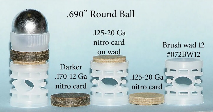

I tried .690 round balls a couple of times. However, out of my guns with Improved Cylinder choke .... accuracy was not stellar.
If you want accuracy, then you will have to find a way to center that .690 ball within the bore. As tiriaq mentioned, this has traditionally been done with a sort of donut wad .... or a donut gas seal.

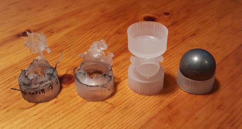

Also, I realized that most standard wads for 1oz or 1 1/8oz loads are not solid or strong enough by themselves and for a round ball.
They will have a tendency to wrap around the ball ..... and then get mangled during acceleration. Some people put one or two 20ga nitro cards inside the shotcup and underneath the round ball and to give that wad more rigidity.

Myself I used the cup from a Gualandi Light Brush Wad to try to center the ball in the bore. But that cup needs several nitro cards as support. Here is a picture of 2 mangled cups that lacked that support. Sporteque has that wad in stock .... I just checked.
