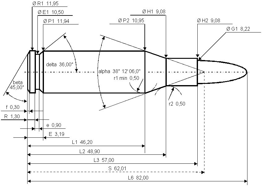

I searched around for dimensions for 8x57mm brass and found this:
I switched to my metric caliper and found all the widths to be within the listed maximums in the diagram. I then stood the cases beside each other to check height and found that the shoulder on the .30-06 converted cases are noticeable higher up the case than the surplus. I measured the height to the start of the shoulder and found it to be 47.26mm. Over 1mm higher than the CIP dimensions!
