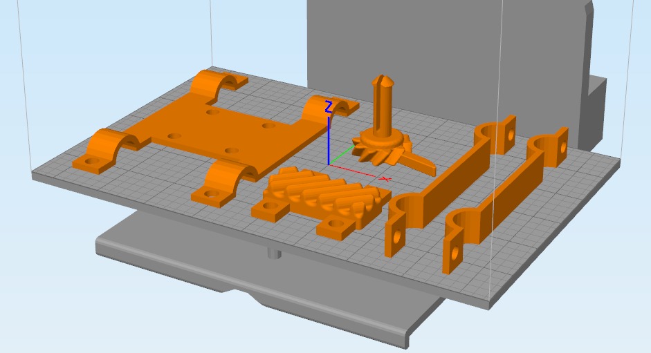

Hello everyone, I like to remove the primers of my shells before wet tumbling to clean those dirty primer pockets, but I noticed it was taking too long to place the shell, decap and then remove the shell and place it into a different container.
So i decided to design and 3d print some automatic extractor method this way my left hand only has to place shells in the shell holder and the extractor removes them pushing them down into a bucket.
I noticed a big speed improvement, at least double speed if not more. Let me know what you guys think about this.

Here are the pieces that it includes, Plus ill add a second rotary extractor in case it breaks.
How did you do the rack and pinion design? Does the software do that or do you have to calculate things manually?
